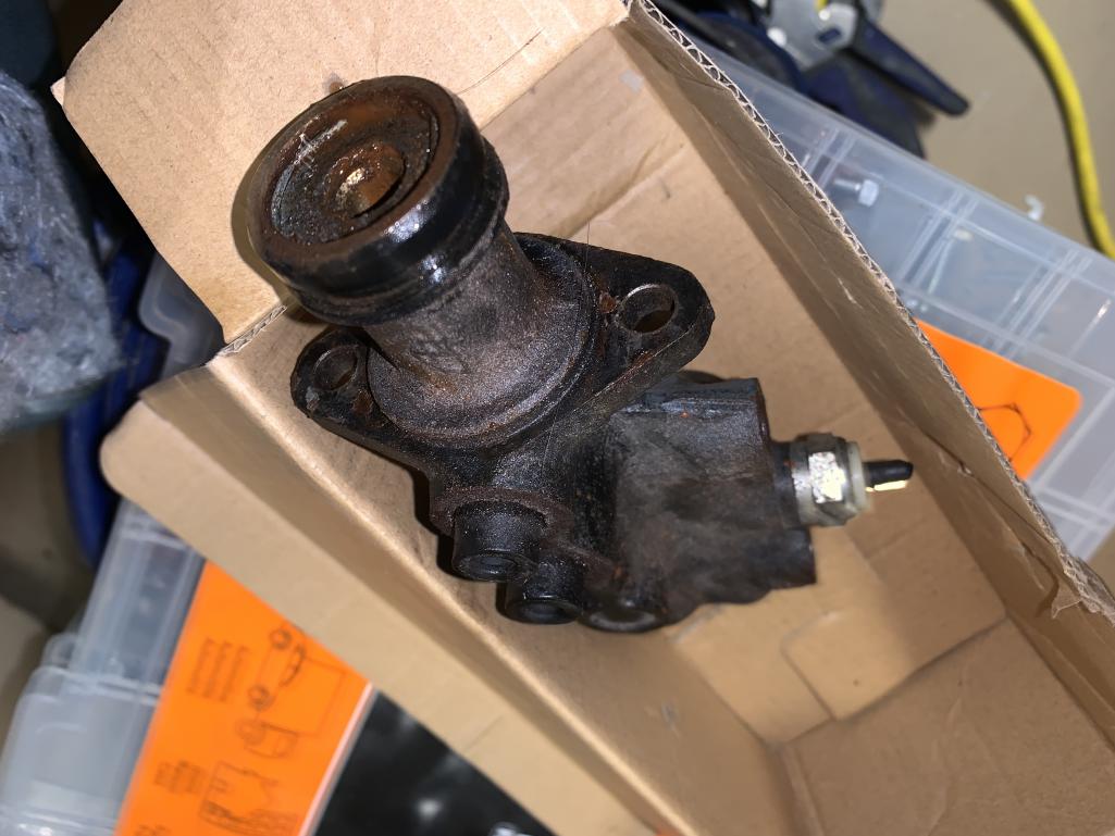

Here is the MC that came out , leaking from front seal

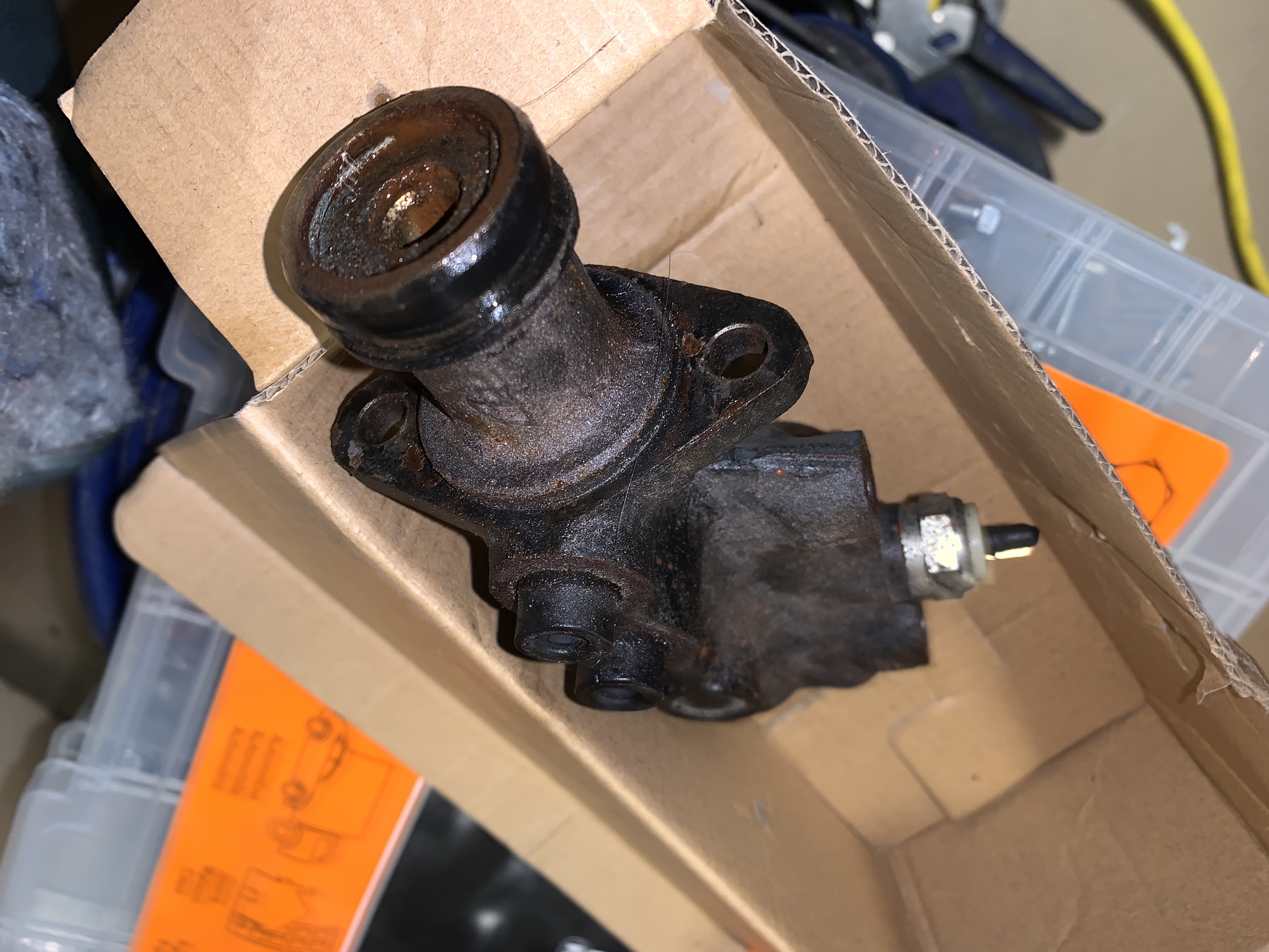

DRPHIL914   Another view I will probably order a rebuild kit ...   Oct 19 2019, 06:17 PM
