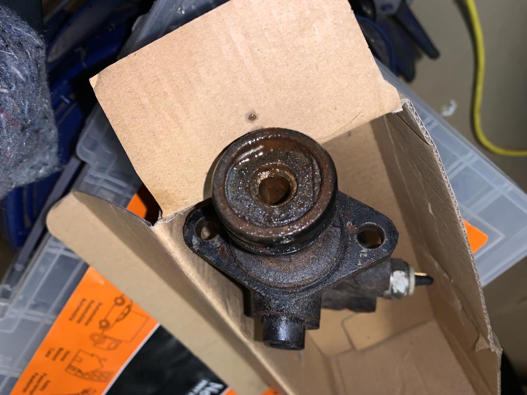

DRPHIL914   5 hours , MC in, pedals removed floor and pedal cl...   Oct 19 2019, 04:12 PM
DRPHIL914   Here is the MC that came out , leaking from front ...   Oct 19 2019, 06:14 PM
DRPHIL914   Another view I will probably order a rebuild kit ...   Oct 19 2019, 06:17 PM
Mikey914   Drop me a call tomorrow. You do want to put the ab...   Oct 19 2019, 11:13 PM
DRPHIL914   Drop me a call tomorrow. You do want to put the a...   Oct 19 2019, 11:42 PM
DRPHIL914   Spoke with Mark and we are pretty sure the wrong o...   Oct 22 2019, 07:06 AM
