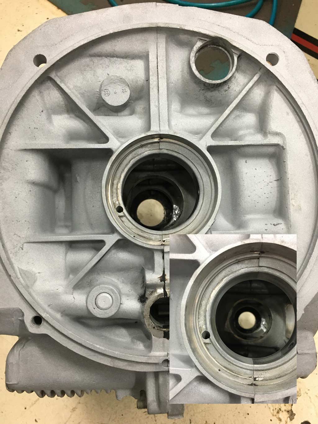

I did notice some differences in this early 099 casting vs. the later version that came out of my car.
Note the differences in casting lot number/date codes
There also appears to be an error in machining the flywheel end main bearing bore.
It looks to me like whatever tool they were using to face mill the case stopped short of a 360 degree revolution.
I can't quite visualize what tooling they were using to cut this surface. The sharp edge, straight line and angular surface left aren't what I'd expect from fly cutting, or a face mill.
Curious if anyone has seen something like this before?

QUOTE(Superhawk996 @ Jul 15 2019, 10:03 PM) *
Note the step mismatch between case halves (yes, the case half ID stamps match so this wasn't 1/2 of one case and 1/2 of another).
There was also that little unmachined tab that partly obscures the main seal oil drain back hole.
I finally got around to setting this GA000099 case up on the mill to fix the mismatch in the Rear Main Seal counter bore area.
Setup and dialed in the bearing bore.
Finished product.
If anyone is interested, I can post a few more details and a short video but mostly wanted to get this fix documented.
