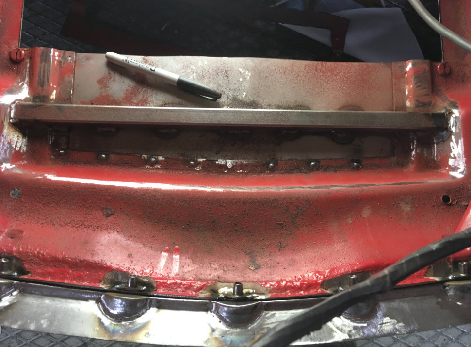

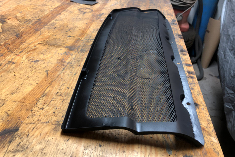

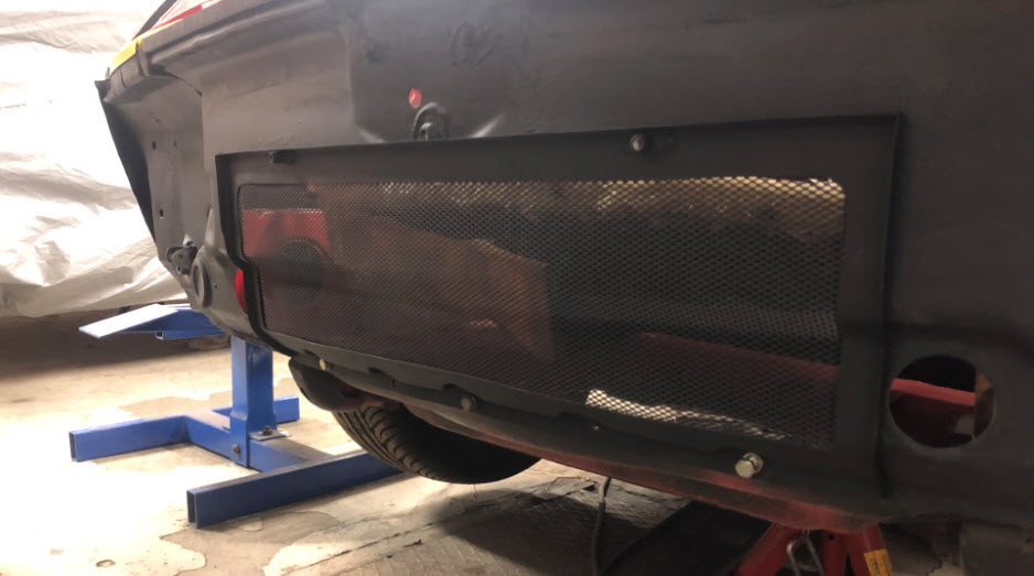

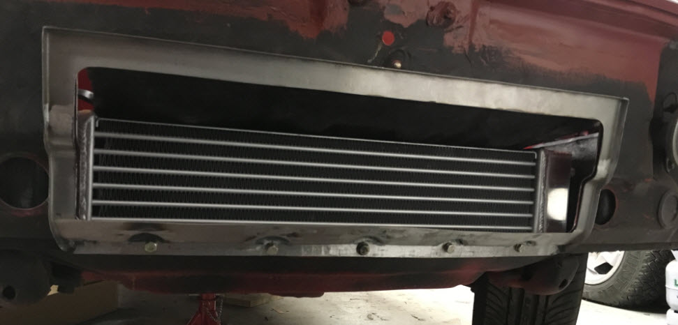

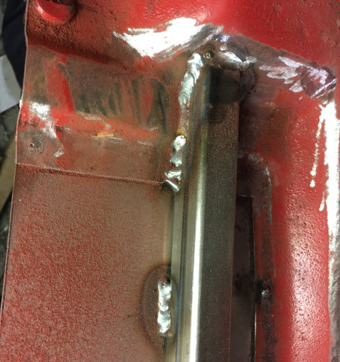

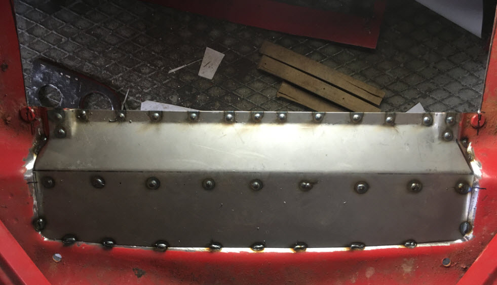

Finished some details around the oil cooler setup.
Fabricated the protective grille and reinforcement in the trunk floor.
Test monting before mesh and paint.
Reinforcement.
Welded in place
Boxing, this stiffens it up!
Paint almost dry (IMG:style_emoticons/default/popcorn[1].gif)
Final test mounting and scratching paint..
