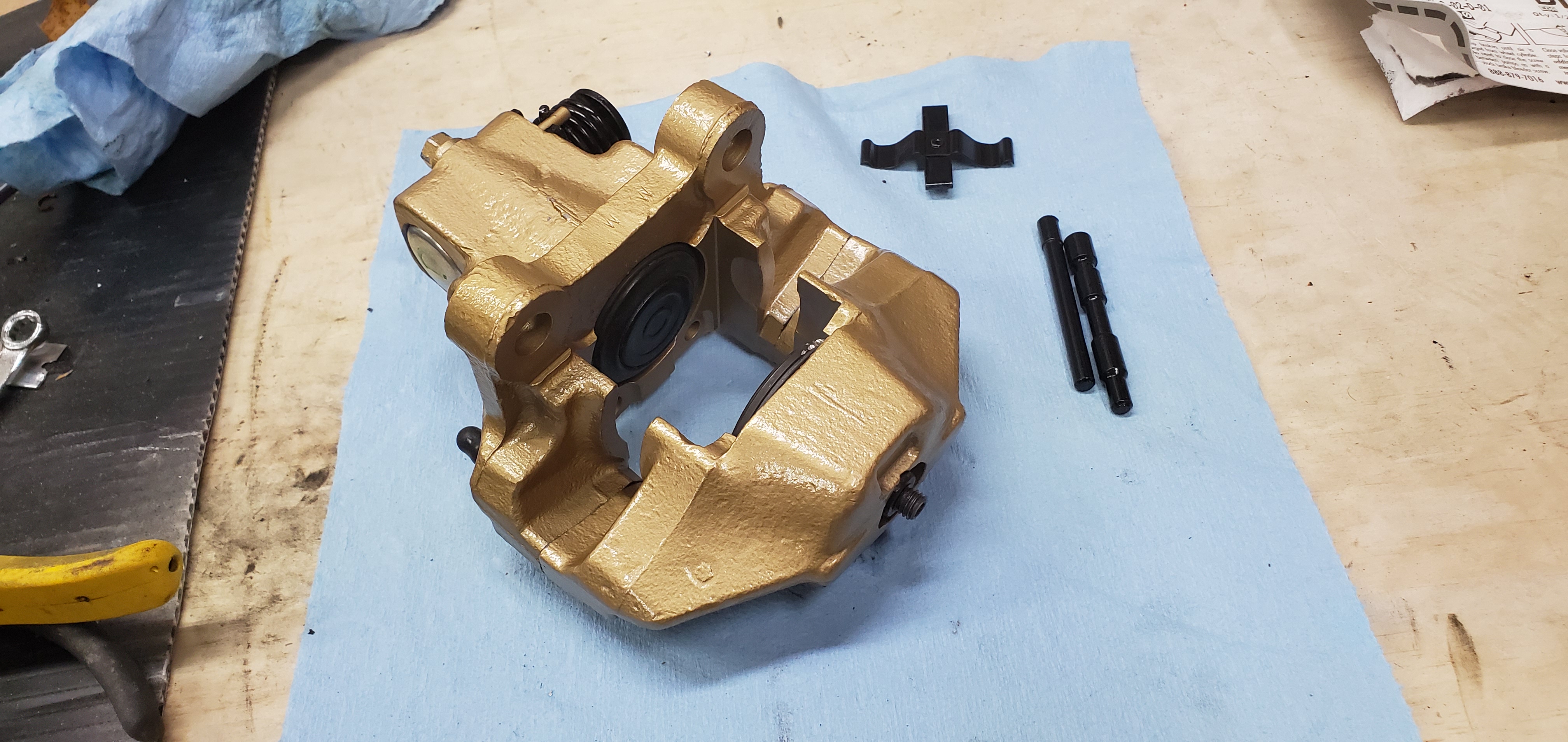

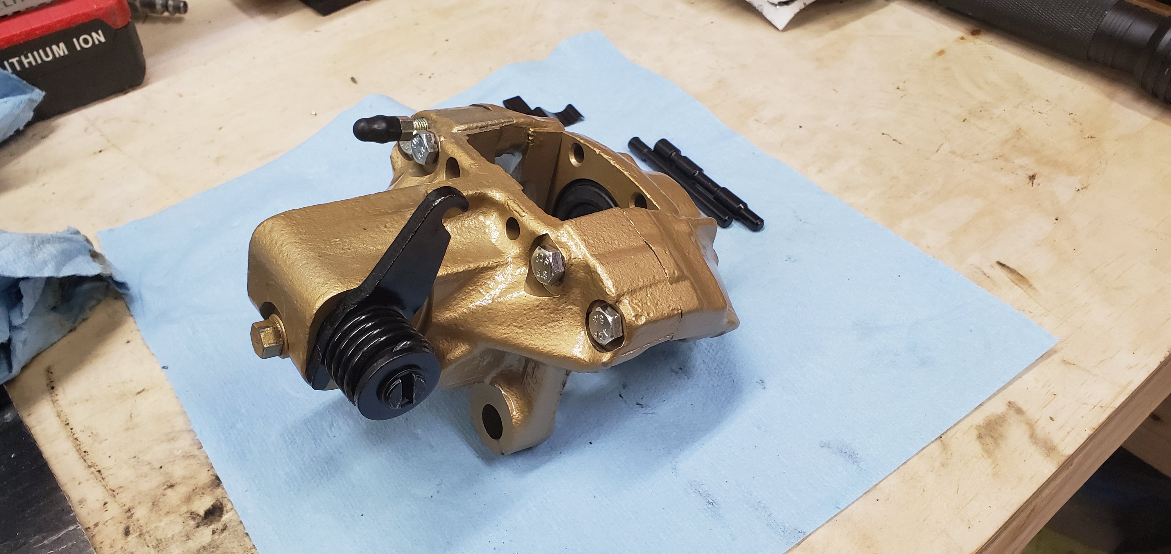

Drivers side caliper rebuilt!
Still sourcing bolts for the other side
Followed the PMB video for the most part with the occasional improvisation lolAttached ImageAttached Image

tvdinnerbythepool   Calipers stripped, blasted and painted. Will repo...   Oct 31 2019, 08:14 AM
Tdskip   It will be. Like all vintage German cars 914s resp...   Oct 31 2019, 10:12 AM

DucRS   Calipers are looking good! Please chime in o...   Oct 31 2019, 11:10 AM
mepstein   Here’s Eric’s /PMB Performance video for rebui...   Oct 31 2019, 11:18 AM
tvdinnerbythepool   @ducrs I followed the pelican disassembly article...   Nov 1 2019, 07:30 AM
mepstein   I’m pretty sure all the calipers had nuts for th...   Nov 1 2019, 07:34 AM
tvdinnerbythepool   I’m pretty sure all the calipers had nuts for t...   Nov 1 2019, 07:45 AM

tvdinnerbythepool   Drivers side sans nuts   Nov 1 2019, 07:46 AM
tvdinnerbythepool   Drivers side caliper rebuilt! Still sourcing b...   Nov 5 2019, 07:46 PM
eatpez   Drivers side caliper rebuilt! Still sourcing ...   Nov 5 2019, 08:00 PM
Tbrown4x4   Yes, those look great!   Nov 5 2019, 09:34 PM
