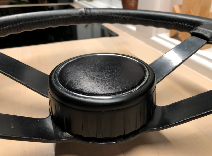

GTSandberg
post Nov 7 2019, 04:00 AM
Posts: 63
Joined: 16-August 19
From: Drammen, Norway
Member No.: 23,373
Region Association: Europe

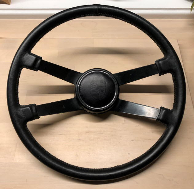

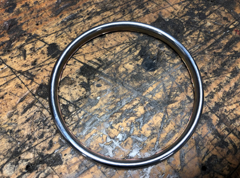

Finaly got the steering wheel finished. Home made hockey puck horn button.

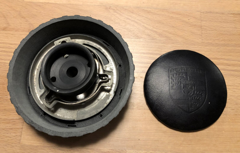

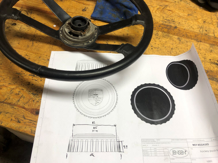

3D model of the plastic part.

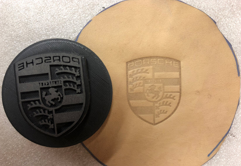

Tool (nr. 3...) for the porsche crest leather stamp. Goat skin from Uganda btw.

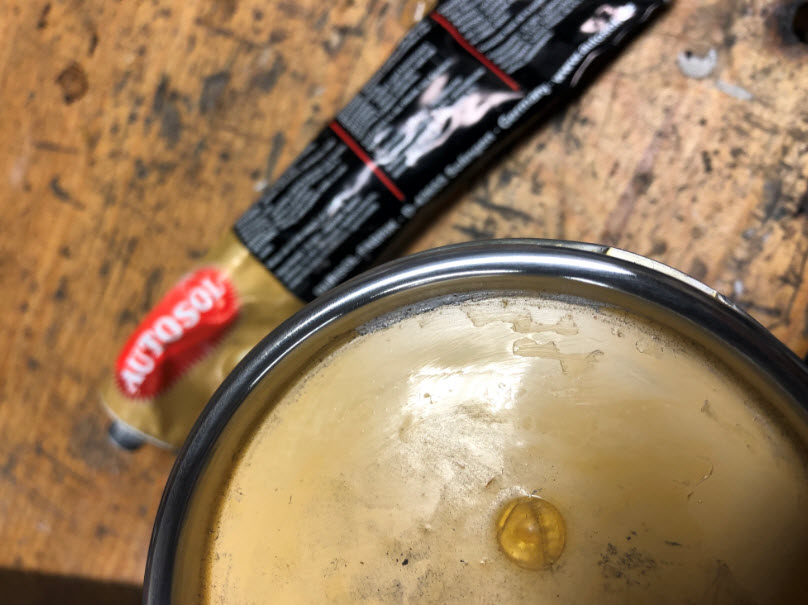

You also need the lid from an Owatrol box (IMG:style_emoticons/default/cheer.gif)
Leather part finished and harware mounted.
