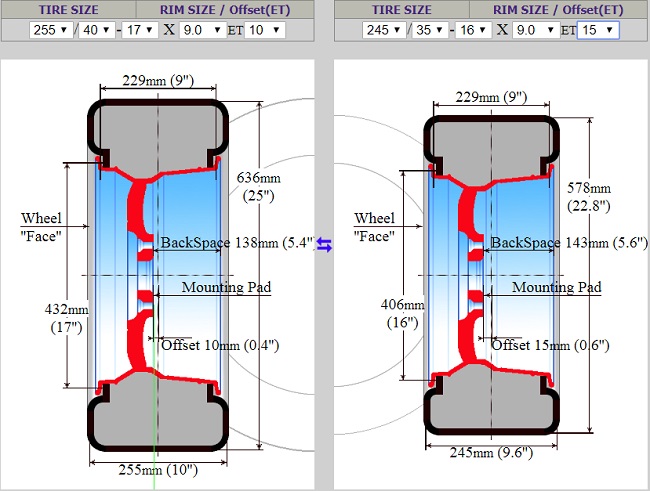

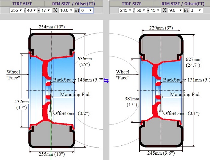

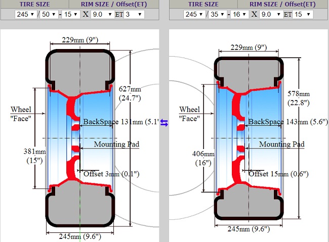

They fit an SC , they will fit GT flairs. My 9x15s rub on SCs with 225s..
But, looking at the pic ..if the SC was lower they would rub..maybe ?? ..need at least a backspace dimension and overall width.
may need to repaint the rear... (IMG:style_emoticons/default/popcorn[1].gif) probably bending or cutting lips min.
found this;same seller from sept.
17" Fikse fm10 3 piece wheels
Hello, selling my set of fikse fm10 3 piece 17"wheels off my 911sc 5 1/2 backspacing. Tires are still in great shape wheels could use a good polish. Overall in great shape.
