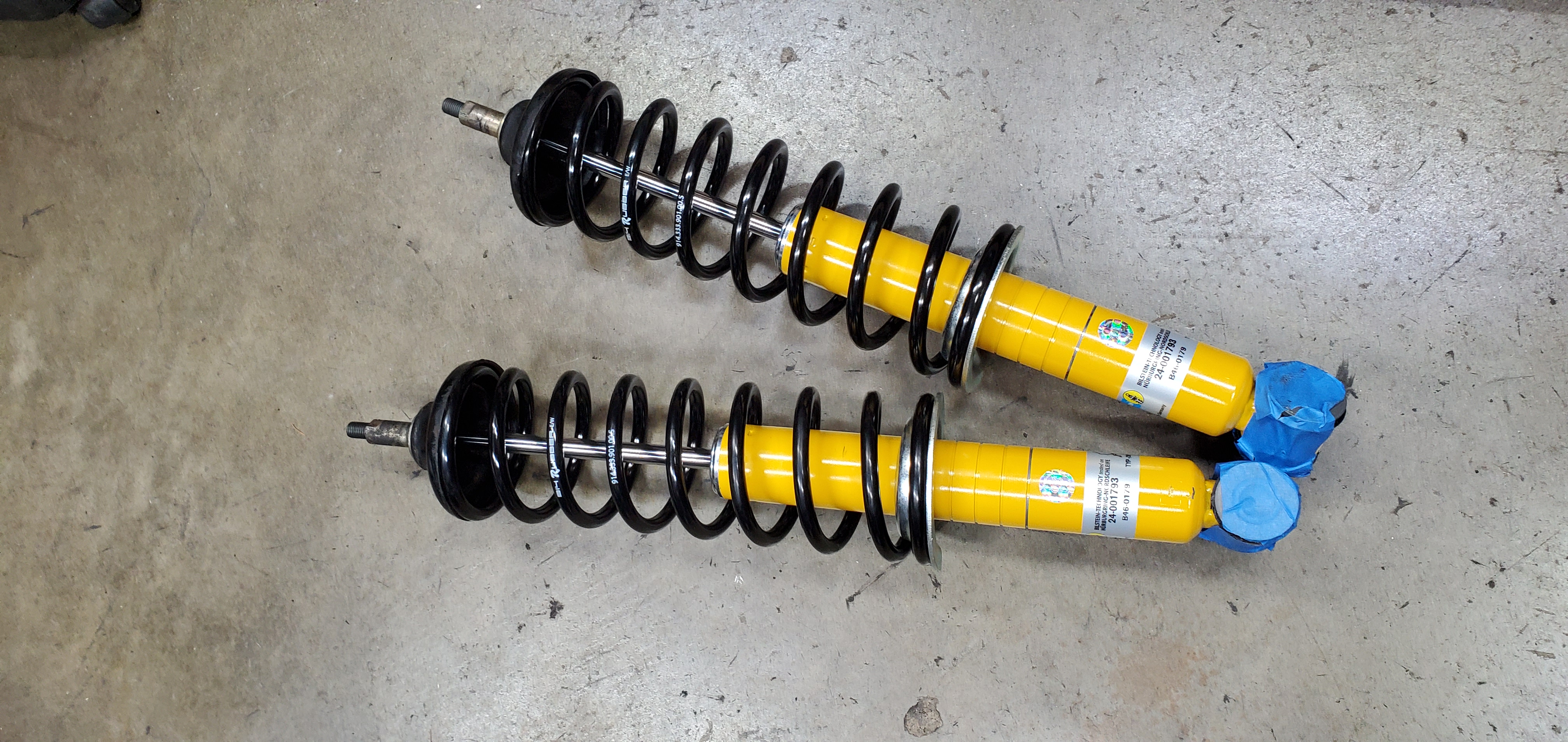

914Rubber 100lb Springs on Bilsteins (IMG:style_emoticons/default/aktion035.gif) @mikey914

tvdinnerbythepool   914Rubber 100lb Springs on Bilsteins :headbang...   Nov 13 2019, 09:45 AM
mepstein   914Rubber 100lb Springs on Bilsteins :headban...   Nov 13 2019, 10:27 AM
tvdinnerbythepool   914Rubber 100lb Springs on Bilsteins :headba...   Nov 13 2019, 11:29 AM
