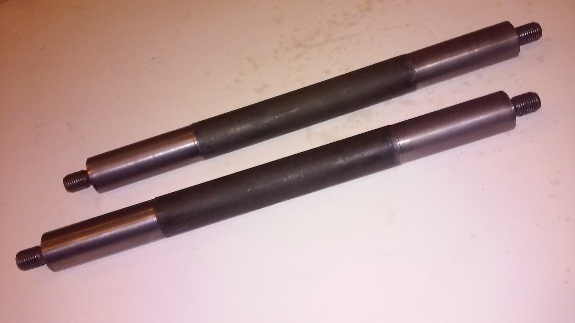

914werke

QUOTE(914werke @ Nov 7 2019, 03:14 PM) *
Shafted!
I've been curious, since you mentioned it in an earlier post, if milling the shafts like that causes any "slop" in the fitment of the new bushings, presuming they are designed for factory dimension of the pivot shafts.

914werke   :( Mmmm IDK... I chuck them up in the lathe ...   Oct 25 2019, 11:42 AM
