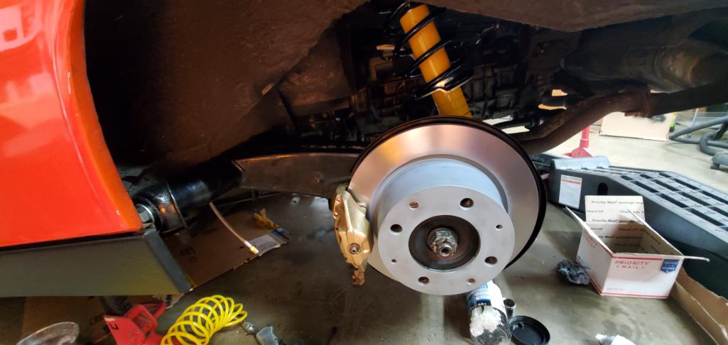

Starting to see some progress and feeling like I didn't ruin everything and she may drive once more. Lol!Attached Image

tvdinnerbythepool   Starting to see some progress and feeling like I d...   Nov 16 2019, 07:05 PM
mepstein   Starting to see some progress and feeling like I ...   Nov 23 2019, 01:36 PM
tvdinnerbythepool   Starting to see some progress and feeling like I...   Nov 23 2019, 02:07 PM
mepstein   [quote name='mepstein' post='2764453' date='Nov 2...   Nov 23 2019, 02:10 PM
tvdinnerbythepool   @mepstein I was thinking the same thing! :co...   Nov 23 2019, 03:13 PM
mepstein   [b]@[url=http://www.914world.com/bbs2/index.php?s...   Nov 24 2019, 12:24 PM
