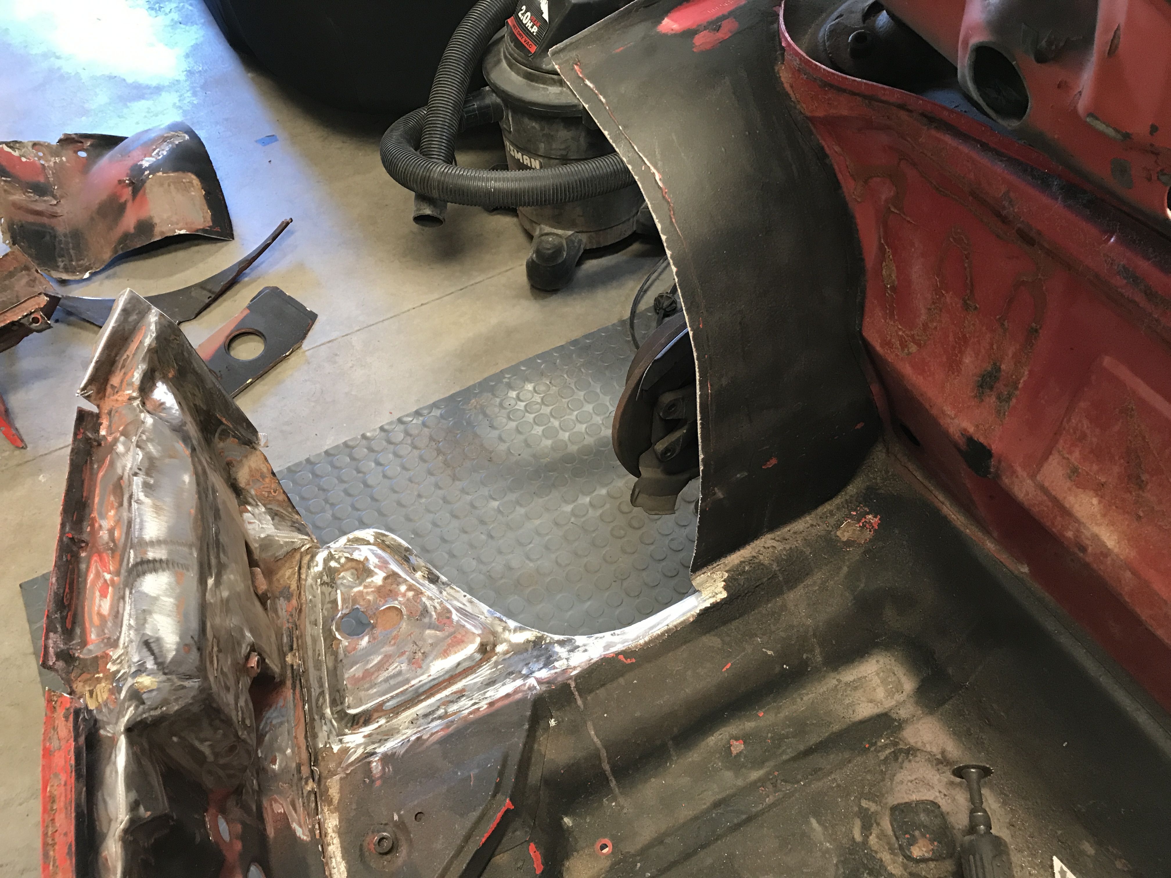

Started surgery on the receiver car. Removed the headlight box and the forward part of the inner fender. Lots of metal work to do on the floor corner.

bkrantz   Started surgery on the receiver car. Removed the ...   Nov 18 2019, 09:34 PM
bkrantz   Here are the parts removed. I will reuse the circ...   Nov 18 2019, 09:35 PM
bbrock   Are you still using your Fein for the cutting? Th...   Nov 18 2019, 09:51 PM
