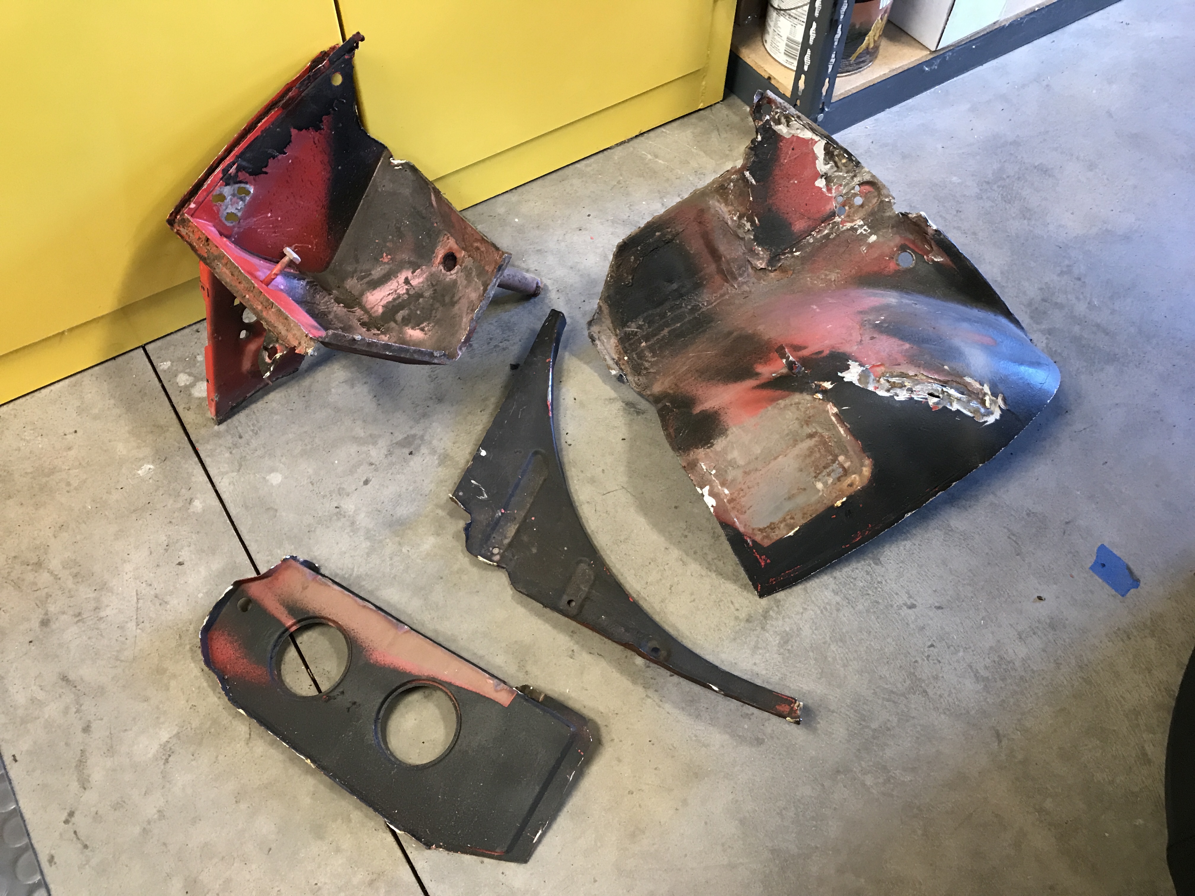

Member No.: 23,343
Here are the parts removed. I will reuse the circular brace.
