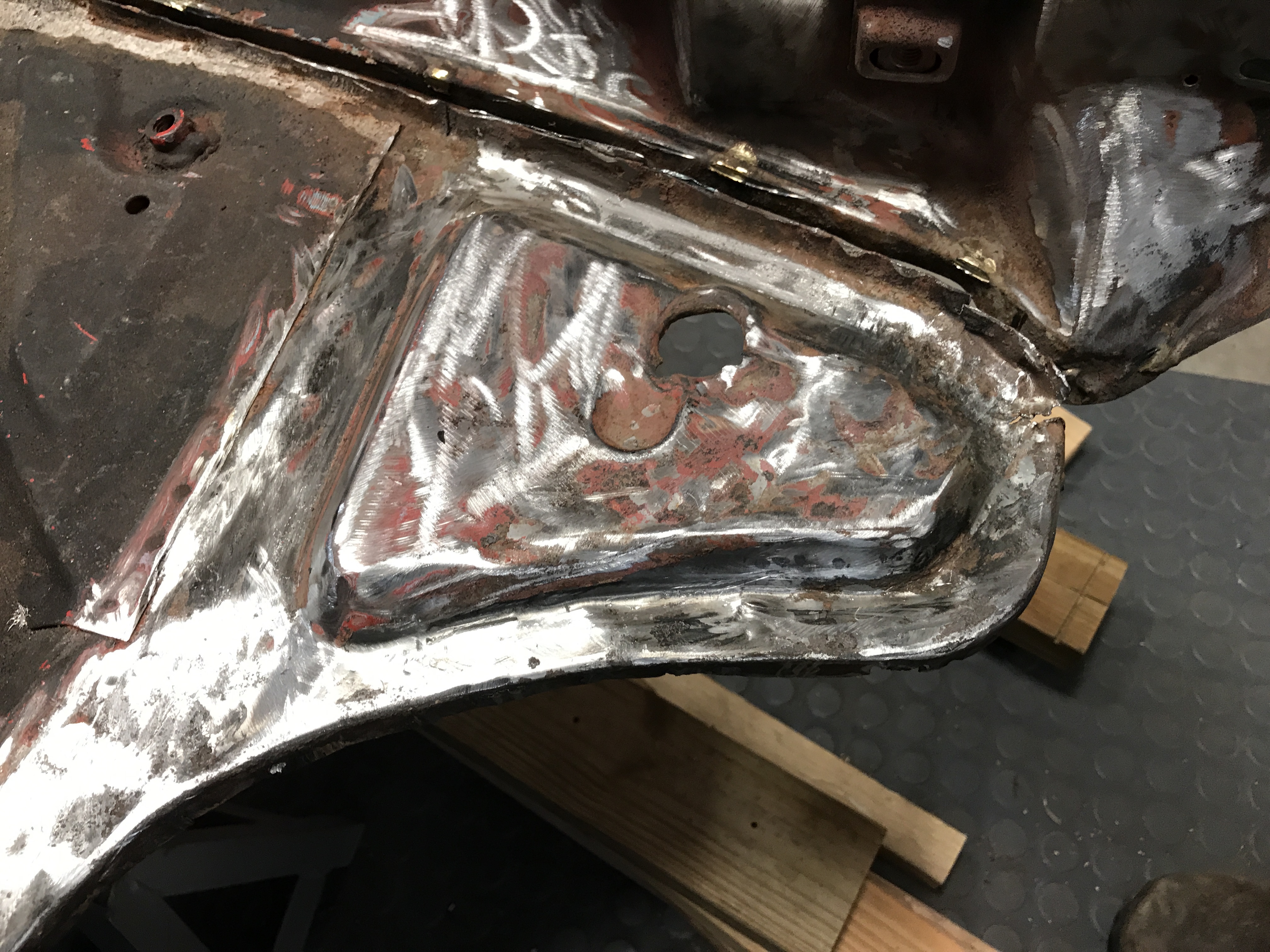

bkrantz   The Fein works best where I can cut from an expose...   Nov 19 2019, 09:19 PM
bkrantz   First pass at reforming the floor corner.   Nov 19 2019, 09:21 PM
