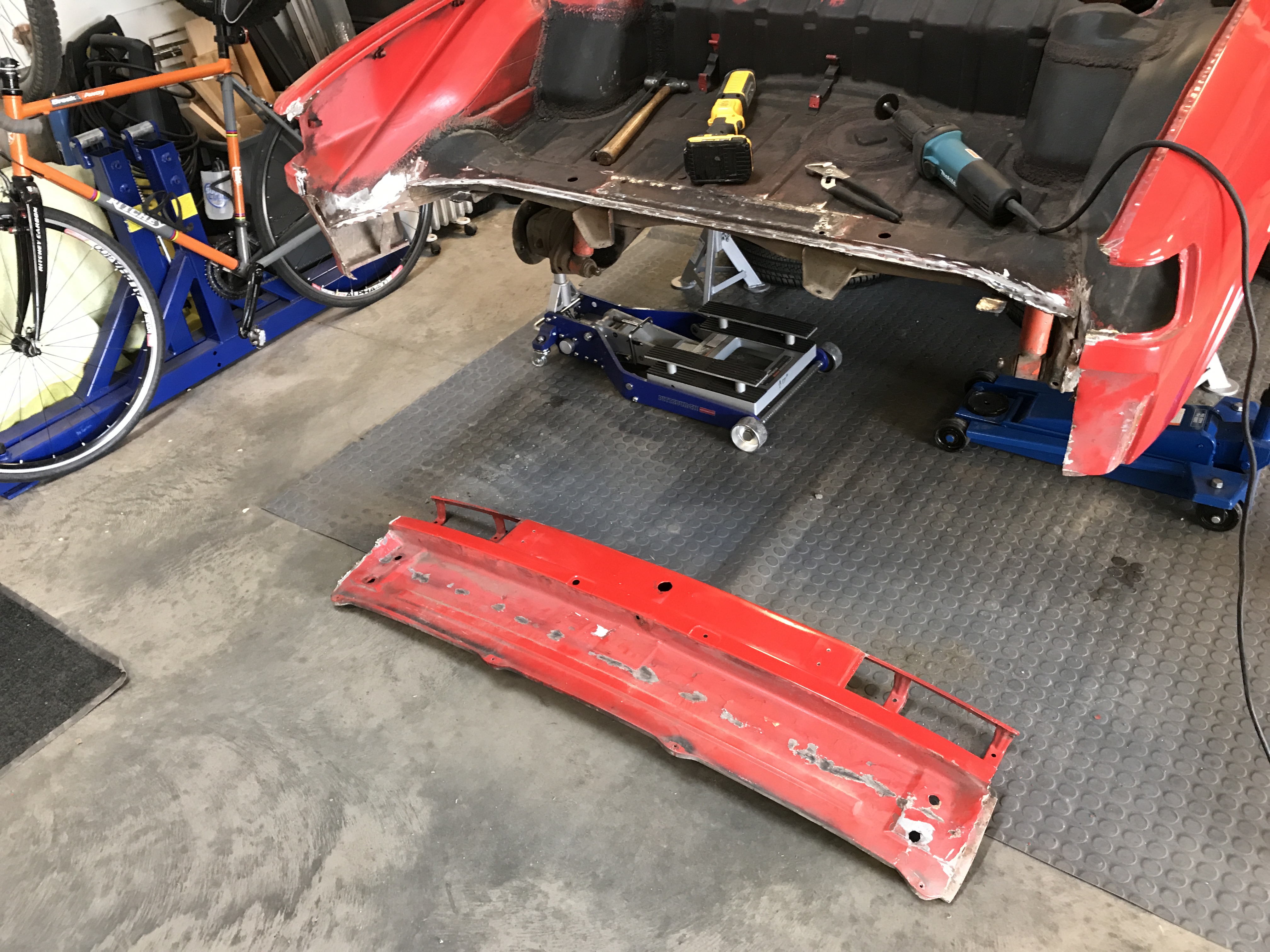

And progress on the rear, removing the rear panel so I can repair the inner-outer fender seems and get the corners right for the replacement floor section.

bkrantz   And progress on the rear, removing the rear panel ...   Nov 19 2019, 09:24 PM
