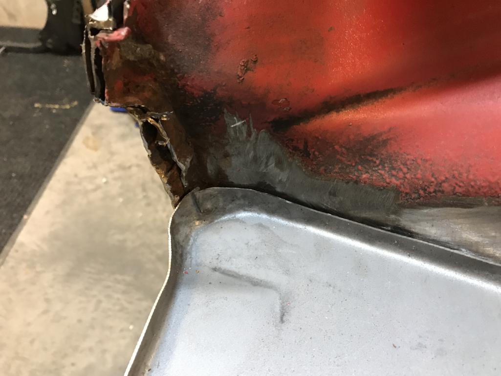

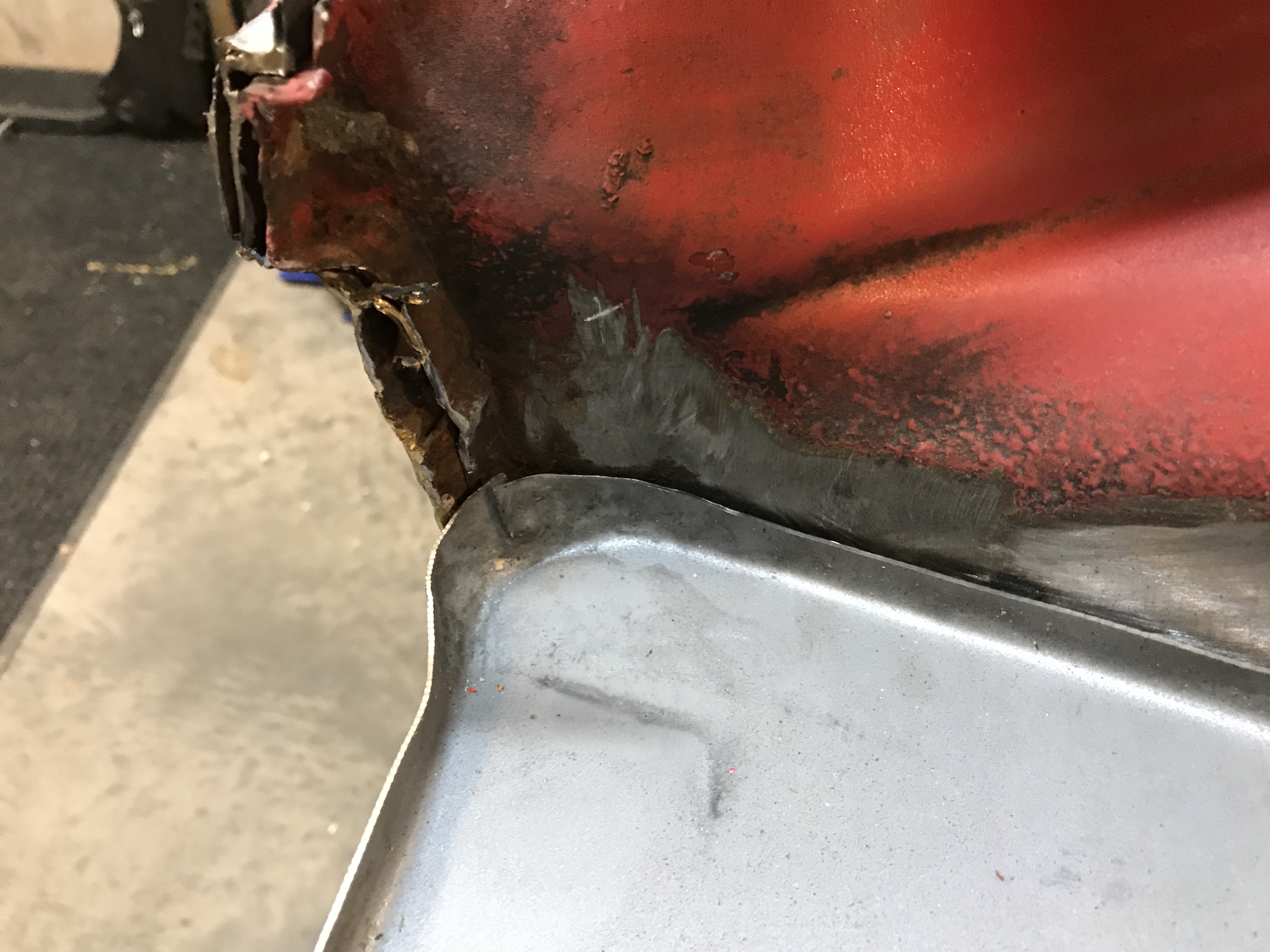

Quick adjustments of the inner fender corners, left:

bkrantz   Quick adjustments of the inner fender corners, lef...   Nov 20 2019, 05:45 PM
