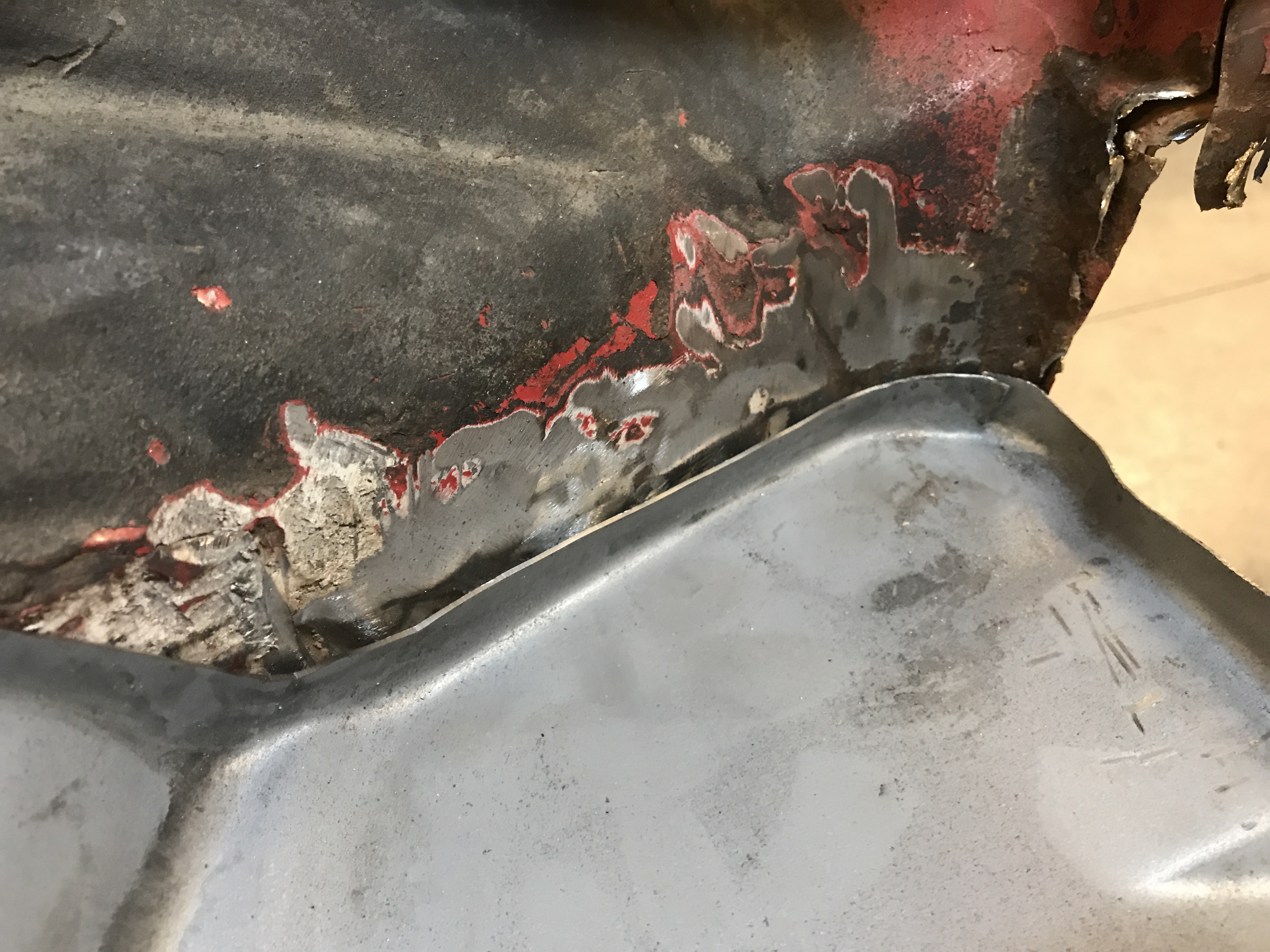

bkrantz   Left corner detail. Pretty nasty work done when t...   Nov 19 2019, 09:25 PM
