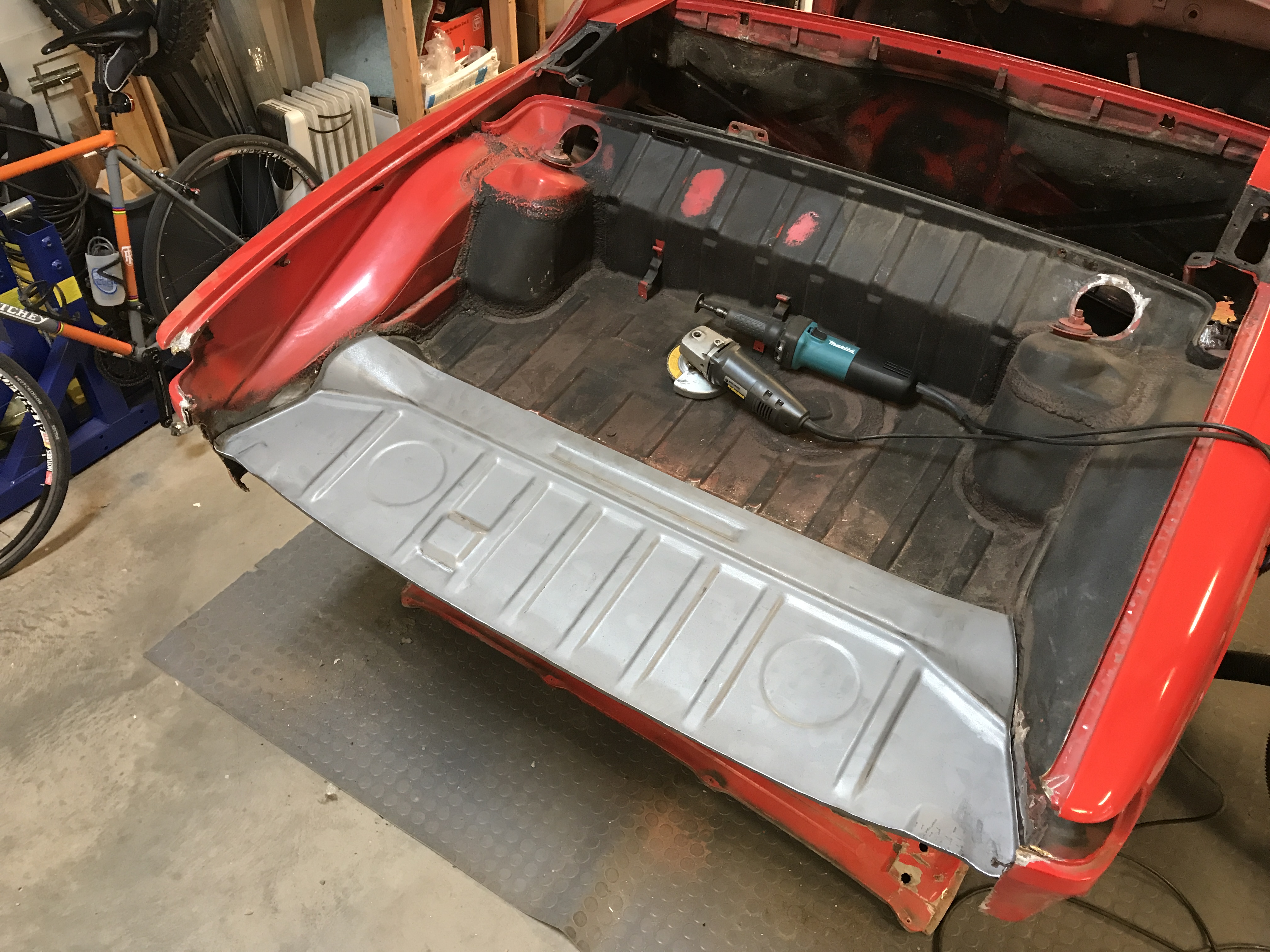

bkrantz   Cleaner cut for the rear trunk floor. Looks like ...   Nov 4 2019, 09:08 PM
Garland   Cleaner cut for the rear trunk floor. Looks like...   Nov 11 2019, 10:37 PM

bkrantz   Now starting on the rear. Weeks ago, I cut out th...   Dec 10 2019, 09:45 PM
bkrantz   And here is the lumpy right side. Previous repair...   Dec 10 2019, 09:47 PM
bkrantz   First effort, left side. Almost good.   Dec 11 2019, 08:38 PM
bkrantz   And right side. Still needs work.   Dec 11 2019, 08:40 PM

bkrantz   Meanwhile, getting started on the rear. First tri...   Dec 23 2019, 09:32 PM
bkrantz   And starting the fit for the rear panel. This wil...   Dec 23 2019, 09:34 PM
bkrantz   Right side is looking better, with access after re...   Dec 23 2019, 09:35 PM

bkrantz   Got the rear panel and outer fender welds mostly d...   Dec 26 2019, 09:09 PM
bkrantz   Left side needed a 3/4 inch wide filler for the ga...   Dec 26 2019, 09:11 PM
bkrantz   Same on the right side, but the gap was only 3/16 ...   Dec 26 2019, 09:12 PM
bkrantz   And what was the lap joint in the front panel, now...   Dec 26 2019, 09:14 PM

bkrantz   Got the trunk floor welded in, with plug welds all...   Dec 28 2019, 09:48 PM
