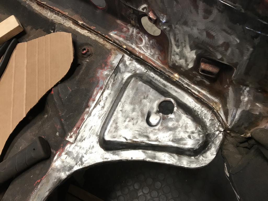

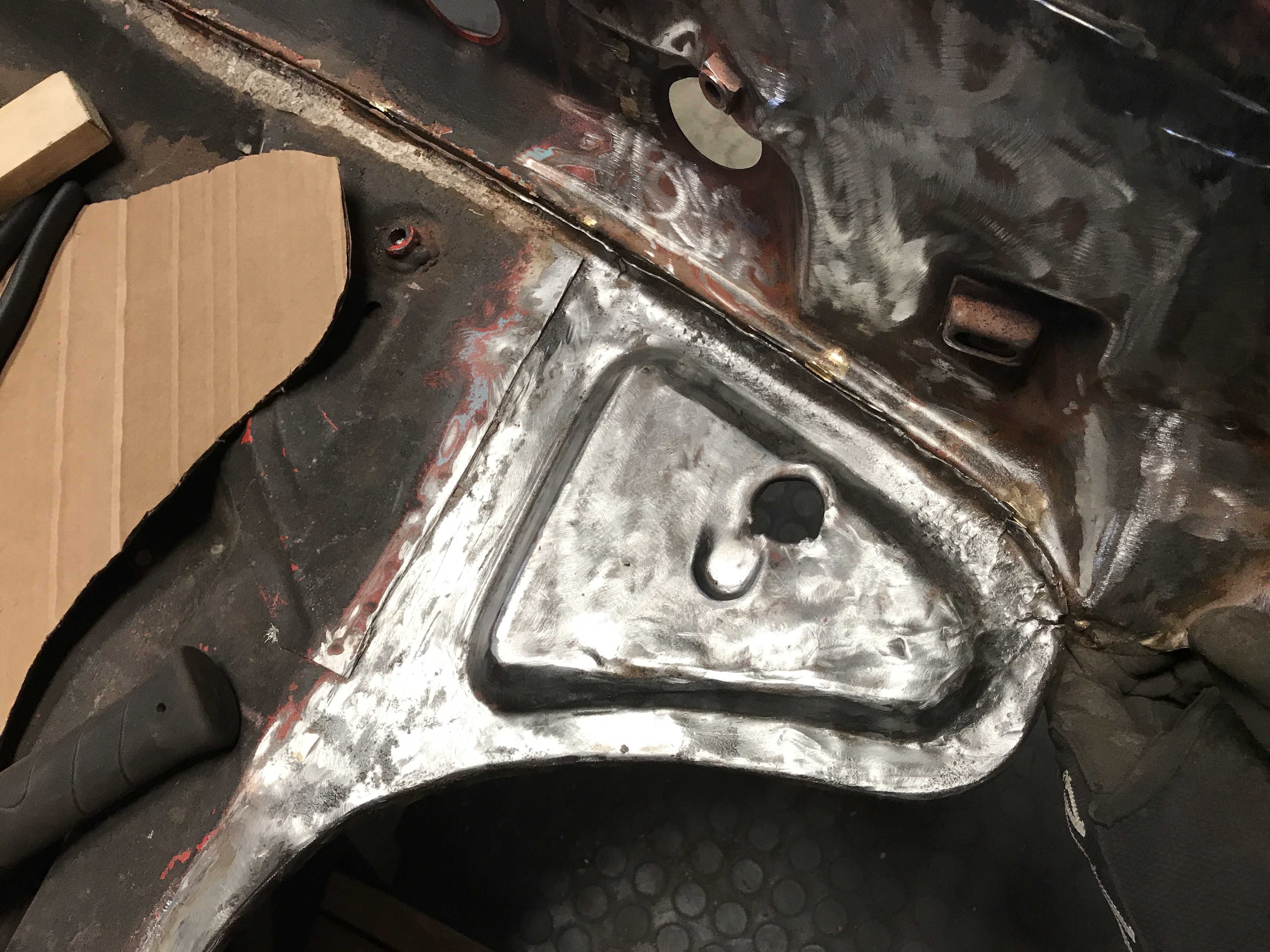

Back at the front, I am probably done working the floor corner, and got the front panel end mostly back in shape.
