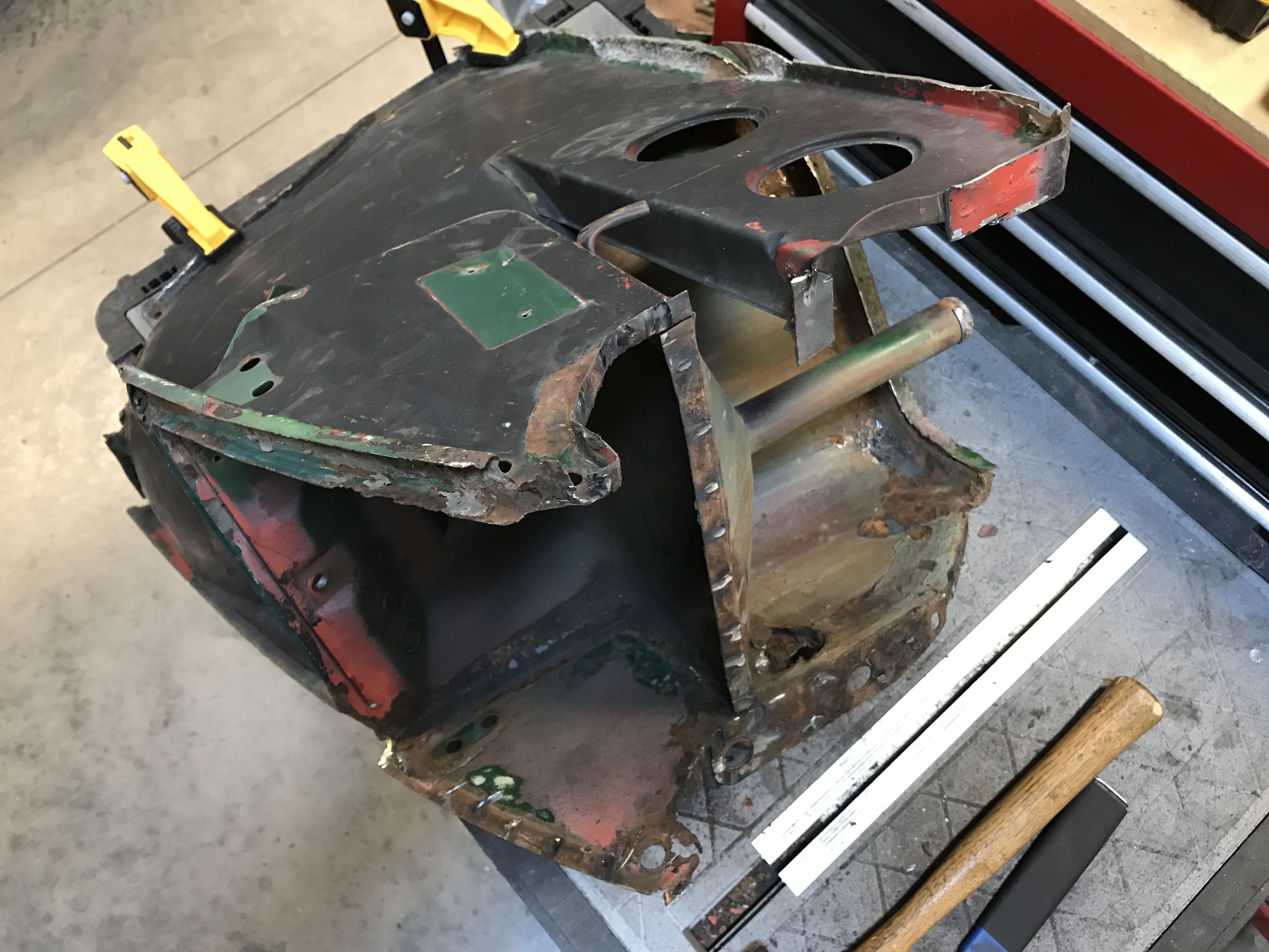

And started to dissect the donor clip. All I need now is the inner fender wall and headlight box. I will keep the vertical brace attached at least until I can check the fit.
Bad news is some local rust that will have to be patched before it can all go together.
