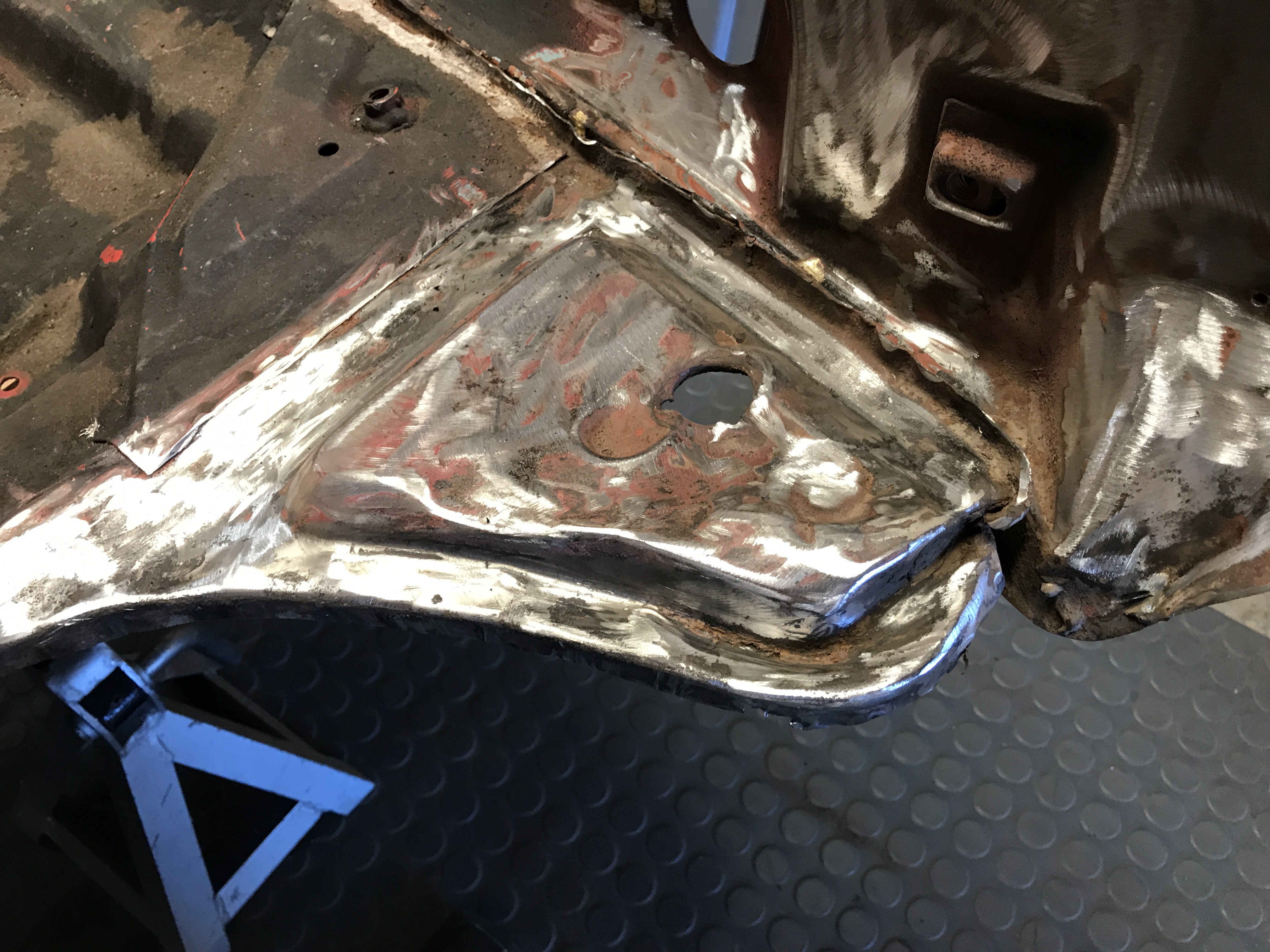

Here's how the front corner started. I feel pretty good about what I was able to do.

bkrantz   Here's how the front corner started. I feel p...   Nov 20 2019, 05:56 PM
FourBlades   Some great progress! :trophy: Nice work...   Nov 20 2019, 05:57 PM
jim_hoyland   Impressive ! :) :beer1:   Nov 20 2019, 06:05 PM
bbrock   :worship: Nice work!   Nov 20 2019, 09:41 PM
