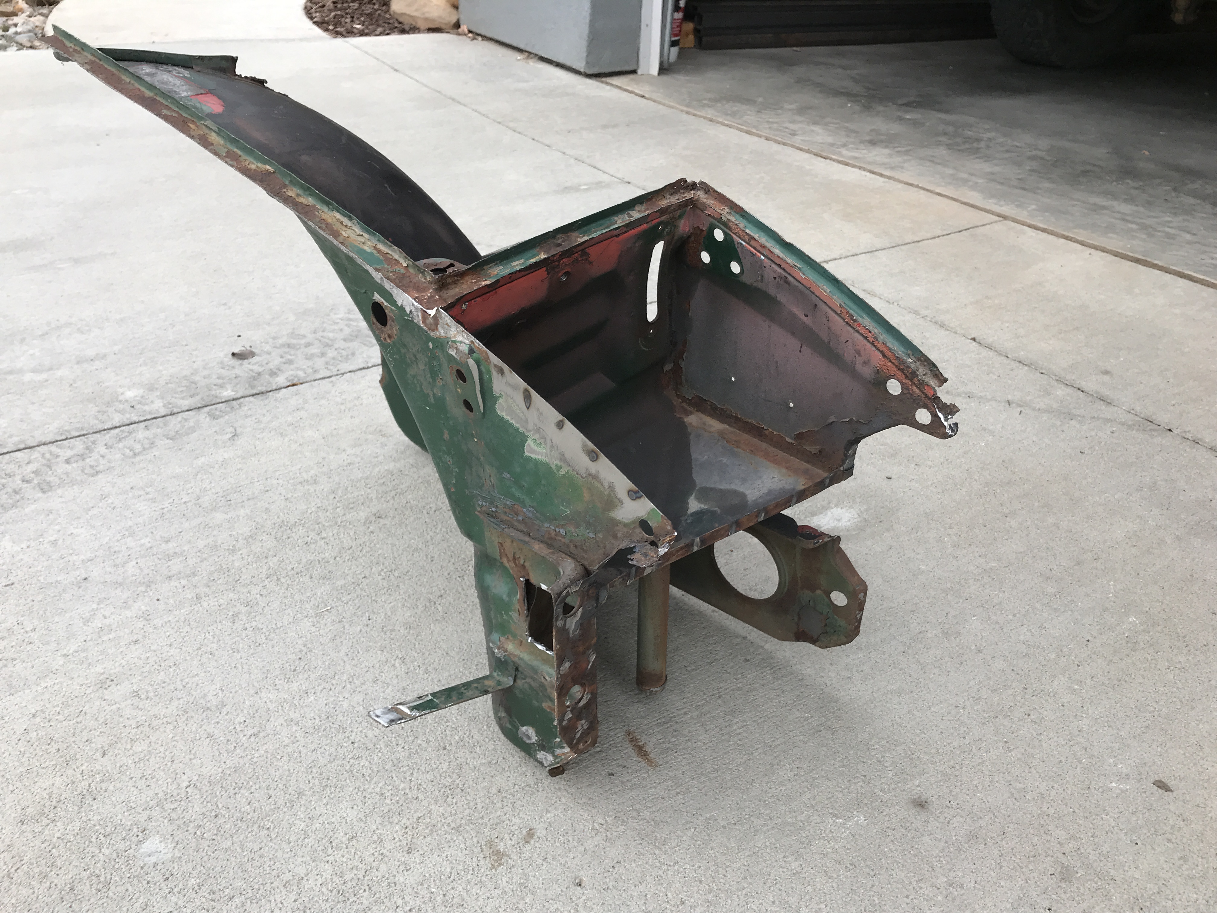

bkrantz   Thanks, everyone. Donor part down to inner fender...   Nov 21 2019, 09:51 PM
