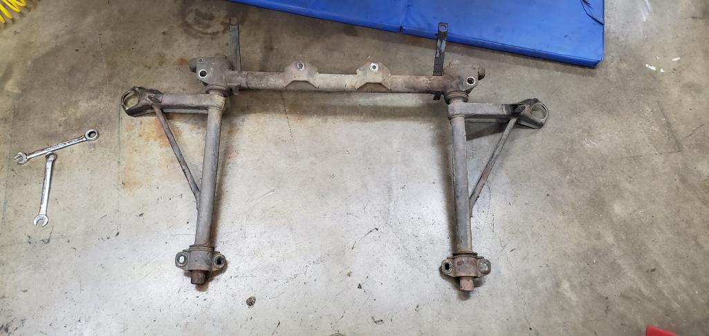

With the back pretty much wrapped up it's on to the front.
Ripped it all out and have a pretty good plan of action.
New A Arm Bushings/Install Tool (914 Rubber + Ian's Video should help)
Bilsteins on the way to match the rears
New Rotors, Pads, Bearings, Ball-joints
New Stainless soft lines
Rebuilding Calipers (Rears went well so here is round 2 for me)
Tie Rod Ends (Stock not turbo upgrade for me)
Bought the install tool for the ball joints, got the old ones out with the air chisel in about 10 seconds surprisingly!
Bushings were totally shot, out of round and a mess.
Anyways, guidance as always appreciated. Have most of the parts on hand if not already shipping to me so I'm hoping to keep the momentum between trips.Attached Image

tvdinnerbythepool   This was the worse of the two sides   Nov 23 2019, 12:55 PM
mepstein   Heat up the fittings that hold the bushings until ...   Nov 23 2019, 01:31 PM
