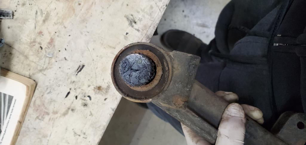

tvdinnerbythepool   With the back pretty much wrapped up it's on t...   Nov 23 2019, 12:54 PM
tvdinnerbythepool   RE: Suspension and Brake Refresh   Nov 23 2019, 12:54 PM
tvdinnerbythepool   This was the worse of the two sides   Nov 23 2019, 12:55 PM
mepstein   Heat up the fittings that hold the bushings until ...   Nov 23 2019, 01:31 PM
