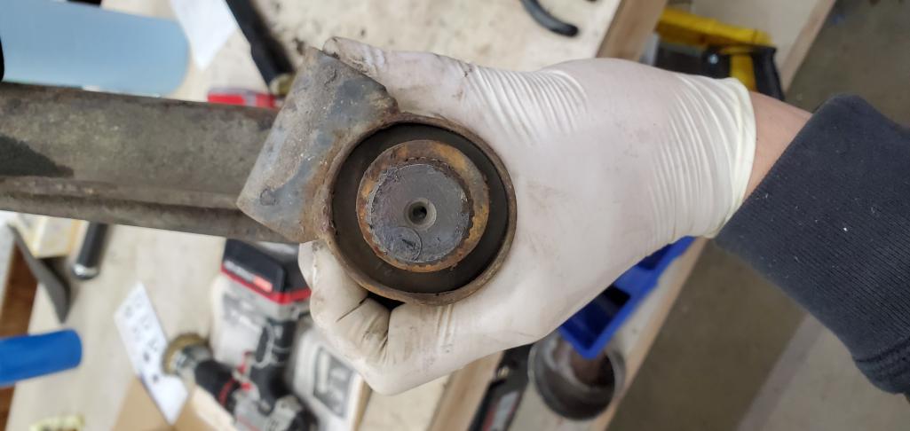

post Nov 23 2019, 12:55 PM
Posts: 310
Joined: 24-July 18
From: Olympia, WA
Member No.: 22,336
This was the worse of the two sides

mepstein   Heat up the fittings that hold the bushings until ...   Nov 23 2019, 01:31 PM
