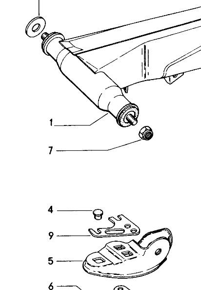

QUOTE(tvdinnerbythepool @ Nov 16 2019, 08:05 PM) *
Starting to see some progress and feeling like I didn't ruin everything and she may drive once more. Lol!Attached Image
I'm curious about the rear shafts. None of the ones I've taken apart seem to have washers on the ends of the shafts. Is that correct?

QUOTE(mepstein @ Nov 23 2019, 11:36 AM) *
@mepstein
I put the washers on there...it just feels wierd to not! Should I take them off? Was there a reason to NOT use a washer?

QUOTE(tvdinnerbythepool @ Nov 23 2019, 03:07 PM) *
@mepstein
No, I'm not saying you are wrong. I put a washer there as well. I'm just wondering why Porsche didn't (IMG:style_emoticons/default/confused24.gif)

QUOTE(tvdinnerbythepool @ Nov 23 2019, 04:13 PM) *
@mepstein I was thinking the same thing! (IMG:style_emoticons/default/confused24.gif)
So I think what Porsche calls the link bearing (#5) that holds the end of the shaft in place is acting as a washer on the shaft. There is a normal washer on the end for the inner suspension console.
