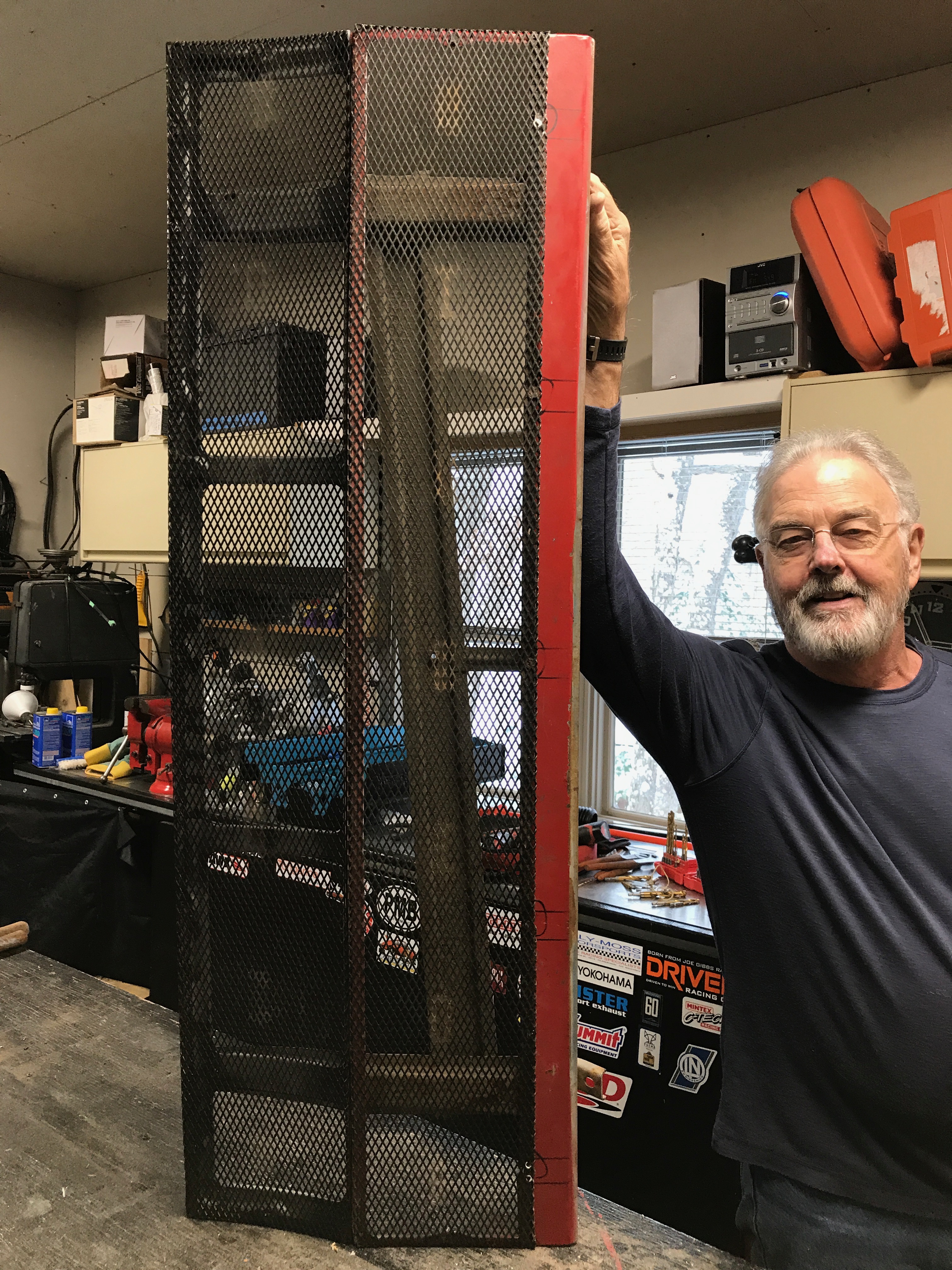

Thanks Eric for the post. My buddy came up to Wisconsin from Florida in March to help me build one. Had lots of fun and it turned out great. MarkAttached Image

mlindner   Thanks Eric for the post. My buddy came up to Wisc...   Nov 25 2019, 06:29 AM
mlindner   Final product just great. Mark   May 23 2020, 05:05 AM
