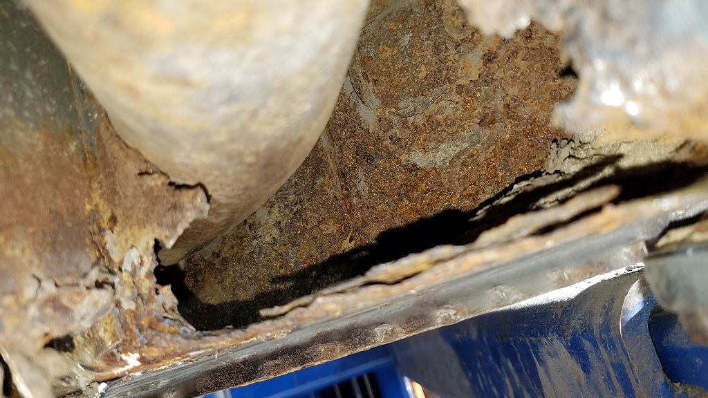

Last spring I got a call from a gentlemen that I will call DP. Please come by and look at my car.
My son and I rebuilt the engine in 2012 and never started it.
So Jack and I made a house call. Laying on the floor I saw the hole in the long. (IMG:style_emoticons/default/sad.gif)
Basically I told him car shouldn't be driven unless the rust is repaired.
Let him know where he fell in the line up of projects.

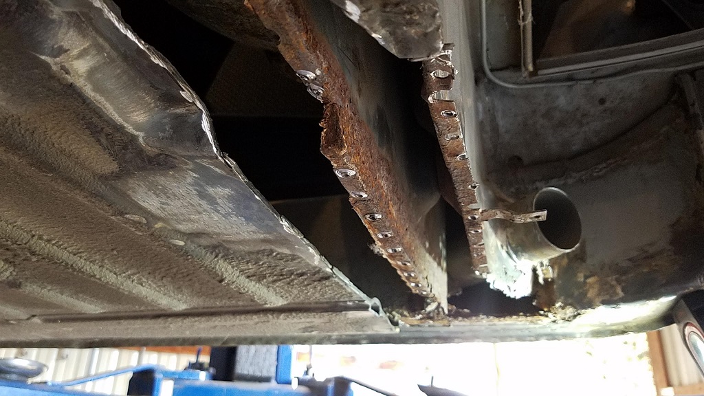

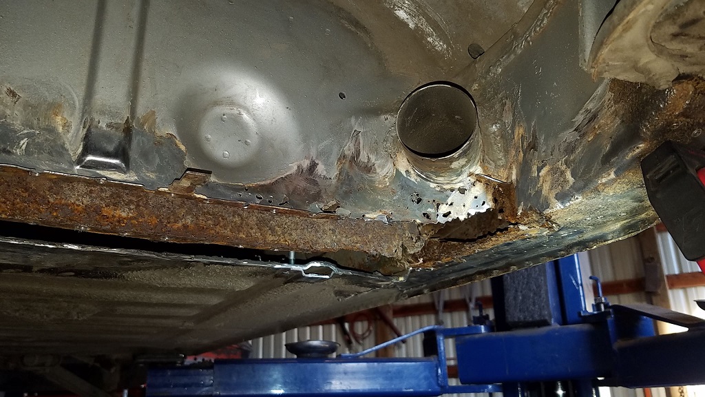

Time to start cutting my way in. But always thinking, how am I going to weld and encapsulate my way out.
I was hoping the damage was isolated to the jack point area. Not to be.
Off comes a portion of the floor. No window leakage damage. Just hell hole damage eating its way up.
Both inner and outer firewalls will need some patching.
