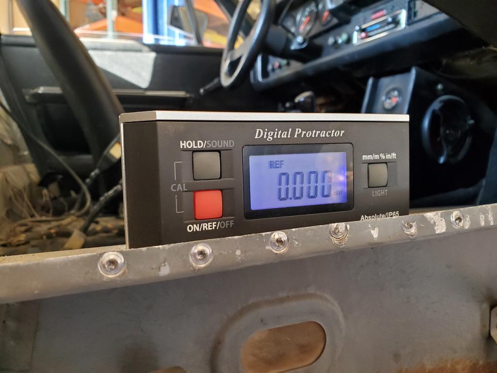

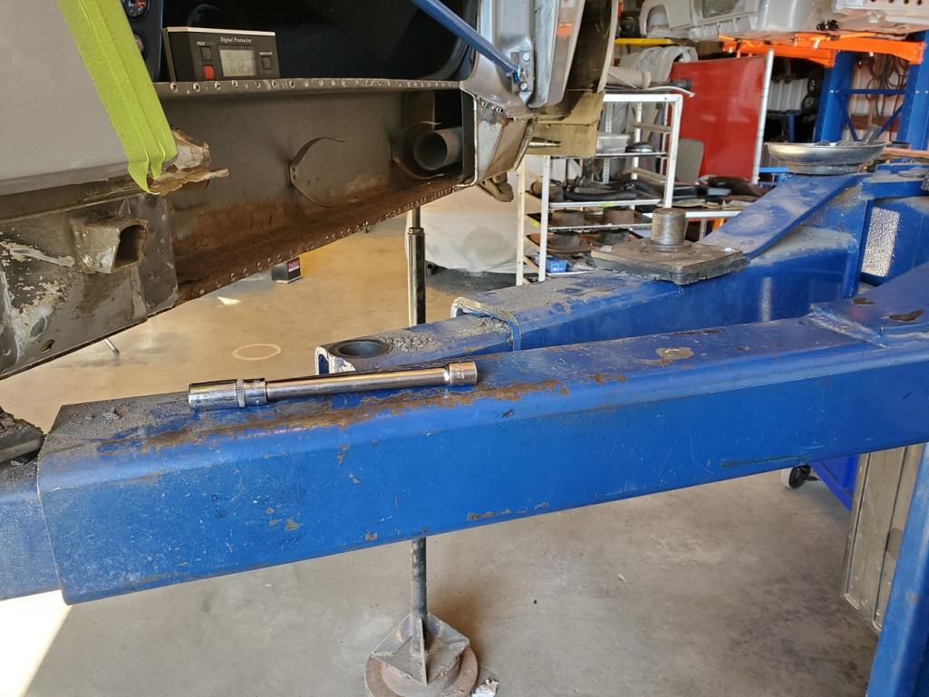

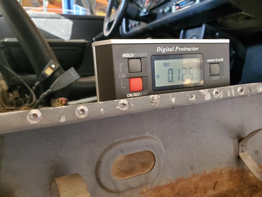

Using the 2 post lift I need to get the front arm out of the way.
Find my level.
With screw jack, raise the car enough to move the arm.
Took a .125" lift to move the arm.
Then dropped it back to zero.
