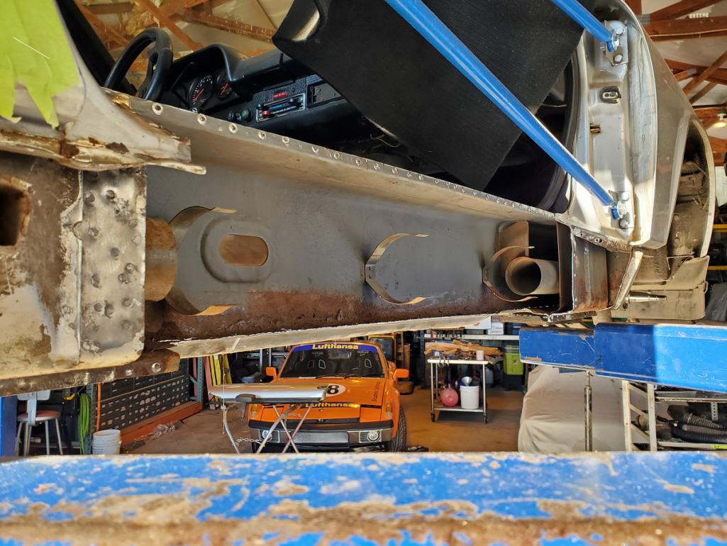

Swung for the fence on the floor pan and hit a home run. Absolutely no degradation on the floor pan under the long.
First a shot of the rusty long up to the edge of the floor pan.

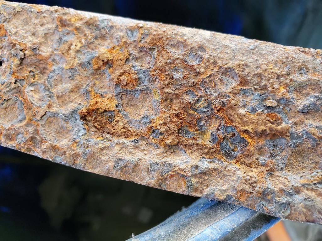

A close up of what I removed.

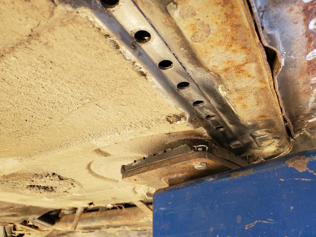

Spot weld cutter drilling out the floor pan.

cary   Long trimmed out. Here's where we sit till t...   Nov 25 2019, 10:39 PM
