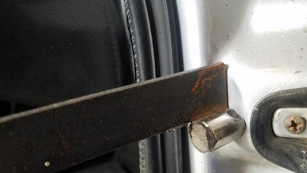

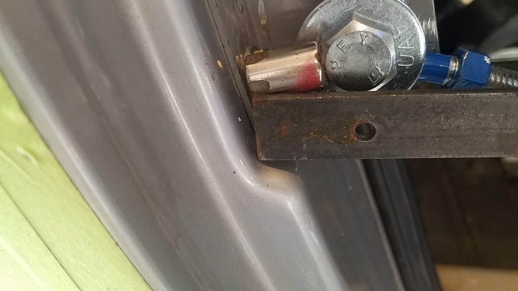

Here is a couple shots of my door gap checking rod.
On this project I'm going to try and work around not completely cutting
the backbone on the long.
1. Door braces
2. Not removing the roof
3. Using the digital level in multiple locations
4. Multiple floor screw jacks (6)
I think we'll create a roof type frame to install on the chassis when a car is stripped
and on the rotisserie and or frame bench.
Frame bench fixtures are next after the engine drop/run stand.
