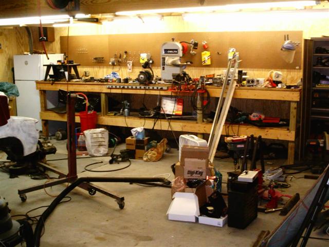

Mine. Very messy.
16 feet wide
36 inches deep
44 inches high
1-1/8 inch ply top
2x6 frame
4x4 legs
44 inches may be a little taller than most, but I like my work where I can see it.
My shop is 24' x 30' at 14' tall. The area above the bench is a storage loft (24'x10'x6')
