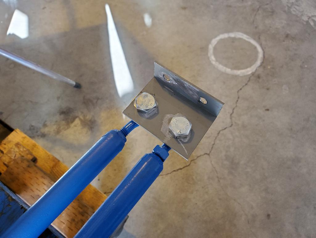

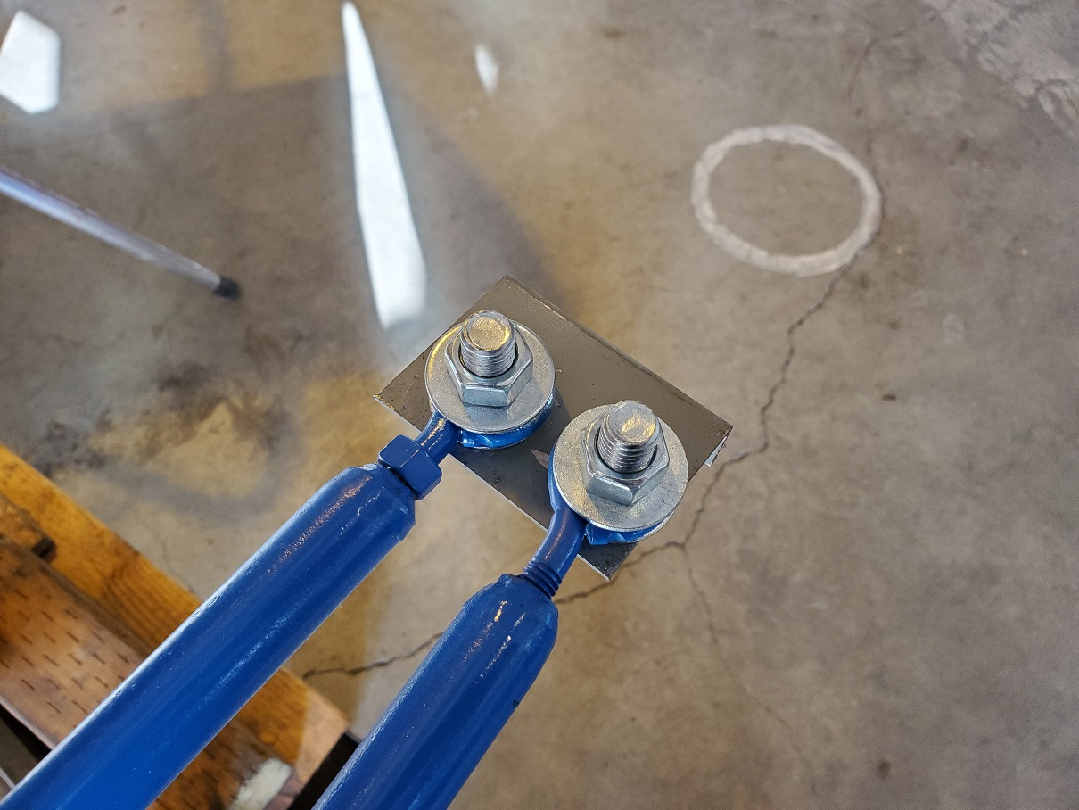

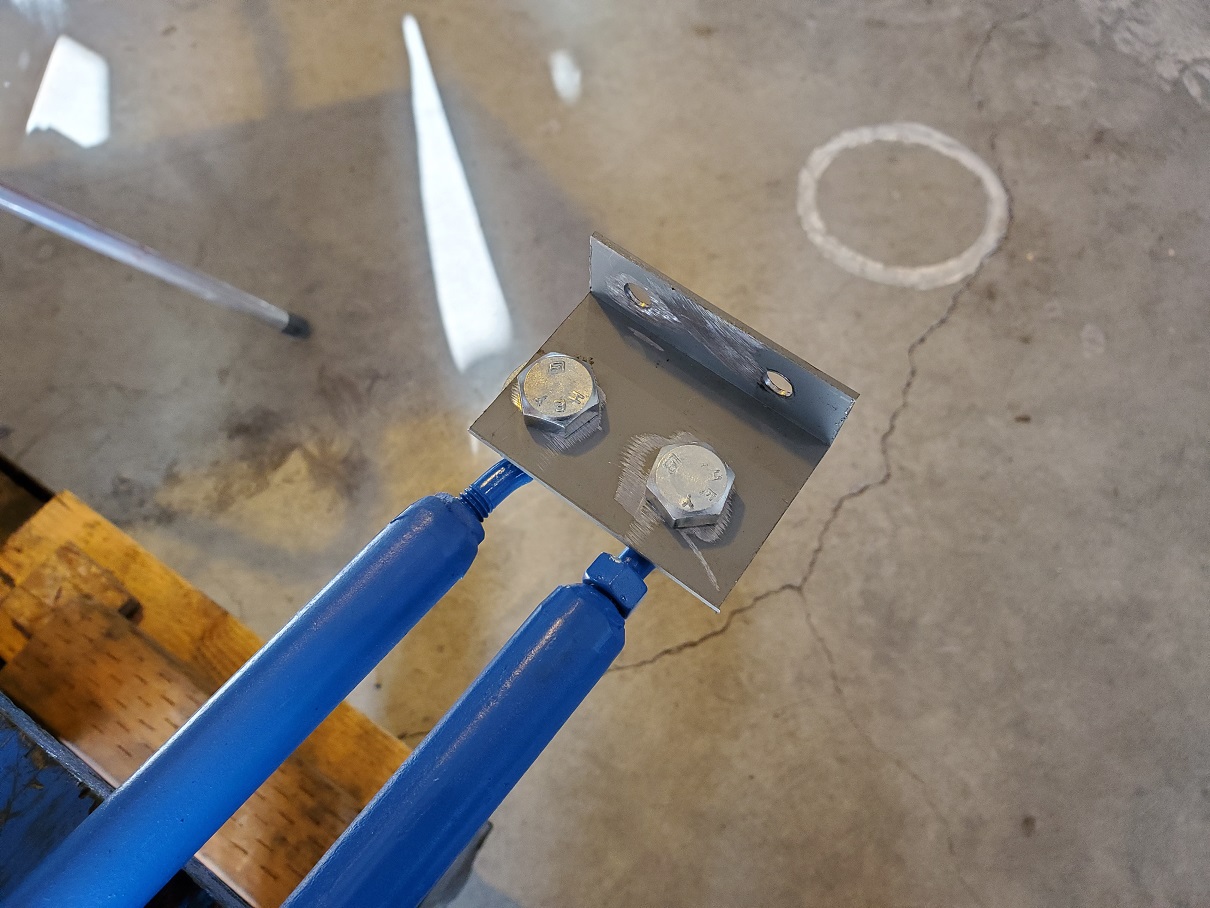

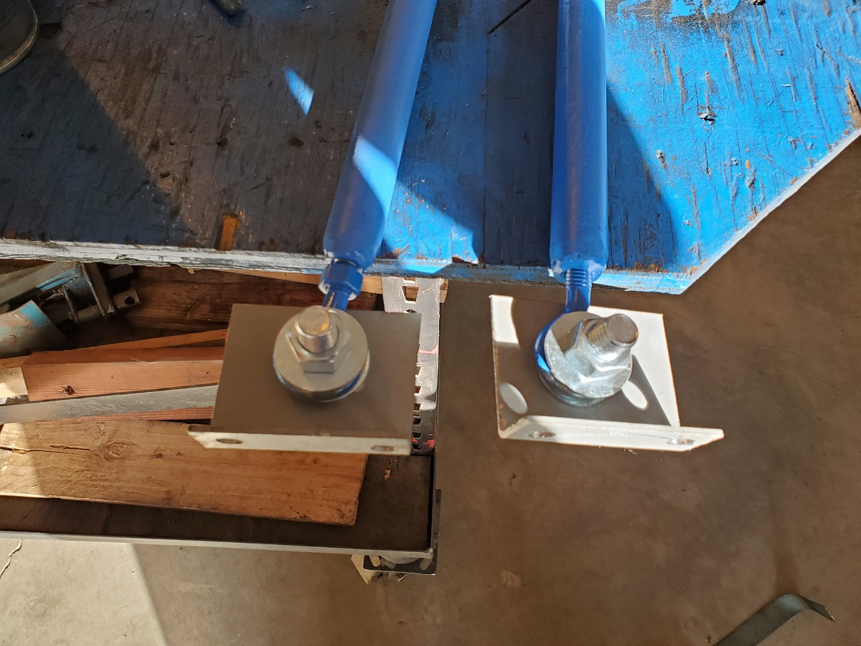

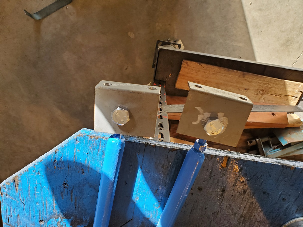

Here's a few shots of my door braces.

cary   Here's a few shots of my door braces.   Nov 28 2019, 09:23 PM

jesse7flying   Thx for the door brace shots Cary. Just what I ne...   Nov 29 2019, 10:57 AM
