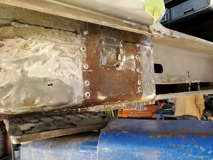

Last spring I got a call from a gentlemen that I will call DP. Please come by and look at my car.
My son and I rebuilt the engine in 2012 and never started it.
So Jack and I made a house call. Laying on the floor I saw the hole in the long. (IMG:style_emoticons/default/sad.gif)
Basically I told him car shouldn't be driven unless the rust is repaired.
Let him know where he fell in the line up of projects.
Picked up the car around the first of September.
Original scope of work :
1. Get engine up and running.
2. Get car shifting correctly.
3. Complete PMB brake restoration.
4. End of day, make car reliable
After getting the car on the lift I gave him my best guess on the hours needed to complete the job.

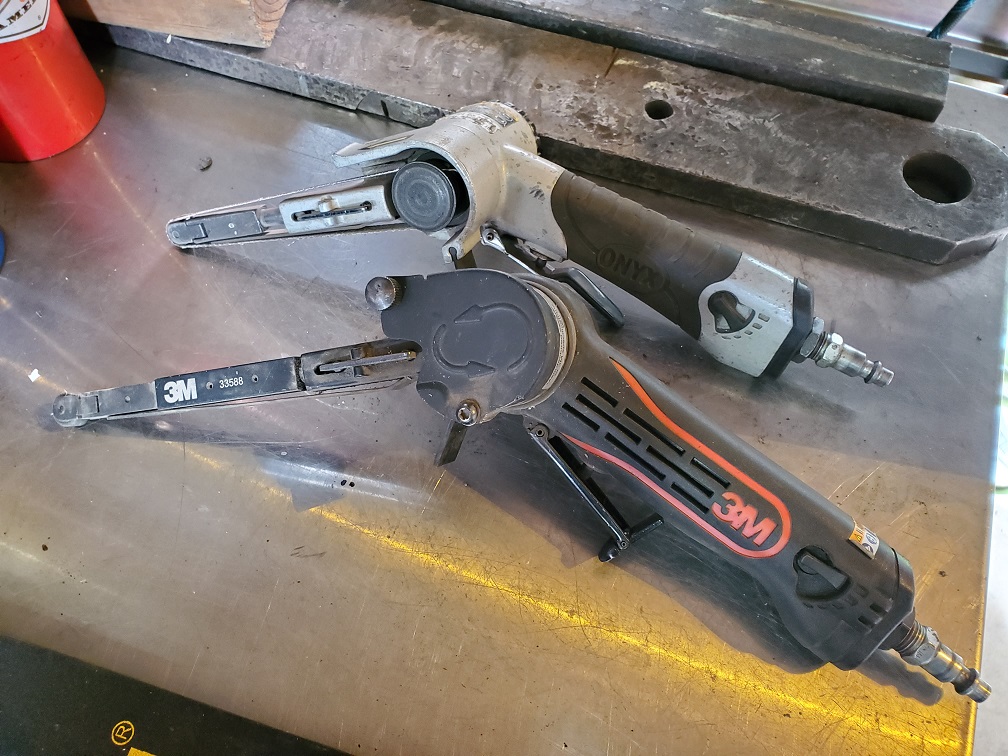

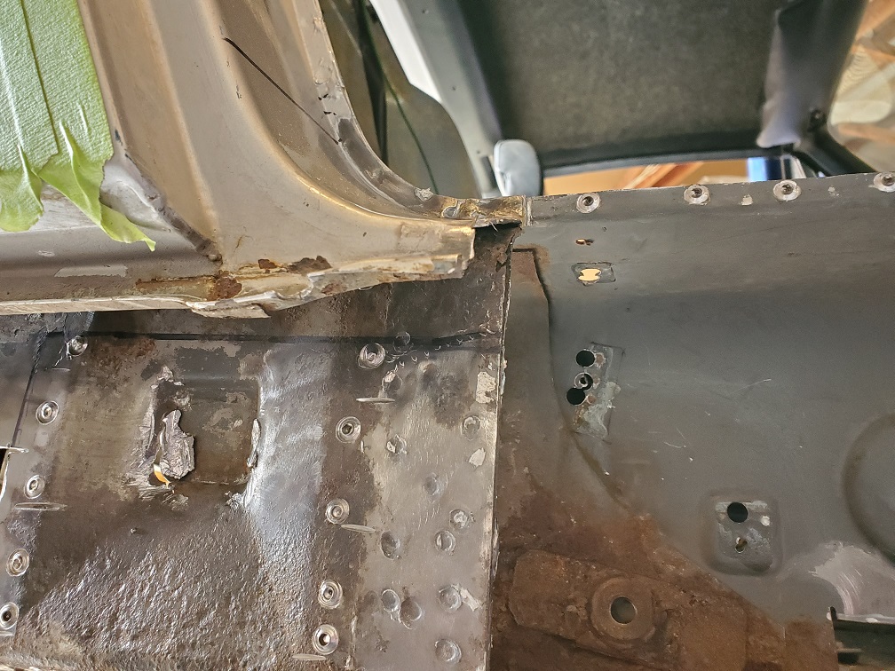

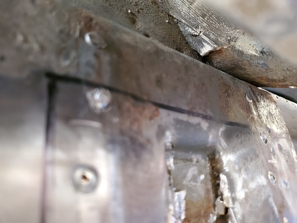

Off came the jack point without cutting into the door jamb.
I have some specially made tools that allow me to do that. It comes off without ripping
any holes under any of the spot welds on upper lip.
Here's one of the tools. 18" 3m belt sander. Allows me to dig out the upper spot welds.
Then peel them back with multiple chisels and spot weld removers.
Might be adding a 25" 3m sander to the tool chest. Longer and perfect fit for the lip.
