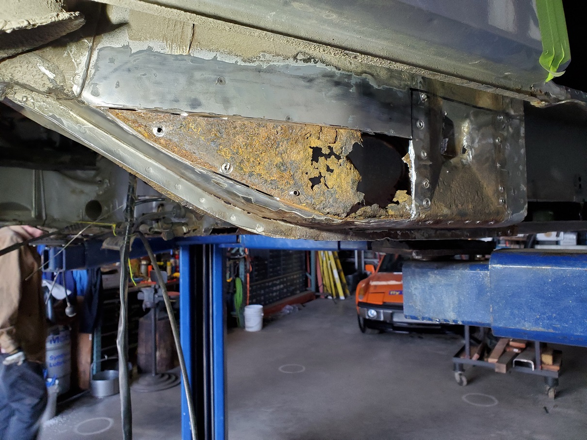

Last spring I got a call from a gentlemen that I will call DP. Please come by and look at my car.
My son and I rebuilt the engine in 2012 and never started it.
So Jack and I made a house call. Laying on the floor I saw the hole in the long. (IMG:style_emoticons/default/sad.gif)
Basically I told him car shouldn't be driven unless the rust is repaired.
Let him know where he fell in the line up of projects.

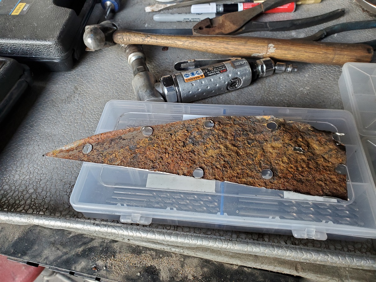

Did a test peel back on the outer wheel house. I can see the stiffener is gone, but maybe, just maybe, the rest of the skin can be saved.
Not .................
Good portion of the outer wheelhouse will need to be replaced.
Now we wait for the sheet metal.
