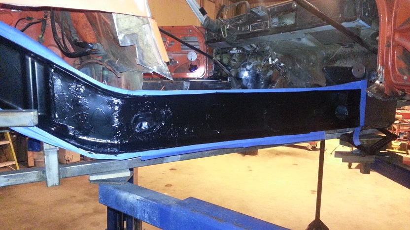

I turned down another one just as nice, but worse. Stunning, it too silver. But starting hole was twice as large. No way I would attempt that one without the frame bench.
This one is borderline .... It's all about keeping the backbone tied together.
Now we wait for sheet metal.
Chris,
I kinda feel bad for the "noodling" time. But its all about the "plan".
Next step is determining my working height and moving in the 4 screw jacks. From there
nothing moves.
I'll feel much better when I'm here ......................
But a whole lot more car attached together
