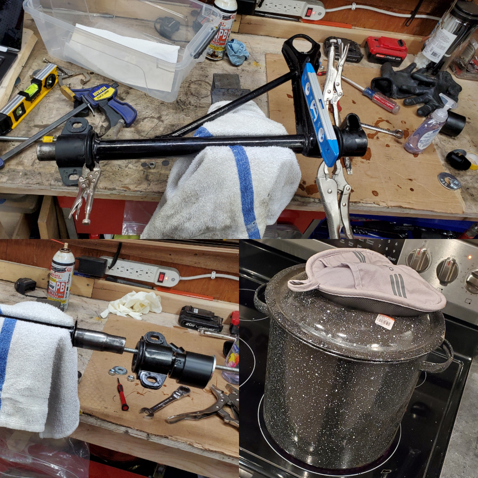

tvdinnerbythepool   Hey guys! I've seen a few methods online b...   Oct 24 2019, 10:24 PM
mepstein   Hey guys! I've seen a few methods online ...   Oct 25 2019, 06:13 AM
914werke   From that pic it looks like you may have more work...   Oct 25 2019, 12:24 AM
Tbrown4x4   I'm reading that you are blasting the calipers...   Oct 25 2019, 05:01 AM
tvdinnerbythepool   @914werke for sure! It was a ton of work just...   Oct 25 2019, 09:59 AM
tvdinnerbythepool   1 down! Took about 40 minutes with heat and pr...   Oct 25 2019, 10:49 AM
TonyA   Like that operating room clean look of your shop....   Oct 25 2019, 01:31 PM
mepstein   Mine took 5-10 minutes each side but I really laid...   Oct 25 2019, 11:17 AM
914werke   :( Mmmm IDK... I chuck them up in the lathe ...   Oct 25 2019, 11:42 AM

tvdinnerbythepool   Bearings are in! Going to make a threaded to...   Nov 14 2019, 11:11 PM
