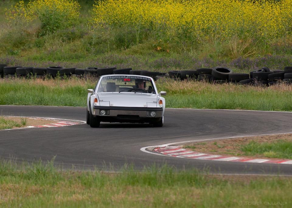

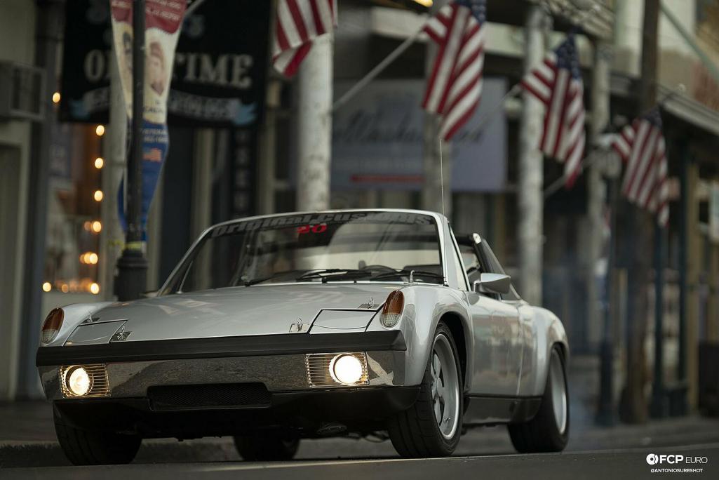

Driveline wise, the stock 3.2 with all of its Motronics cannot be beat. I would drive mine anywhere. Your metric though, might be a little unrealistic. After 500 miles in my 5 Series X Drive BMW I would feel beaten up from sitting. I’m sure a stock 3.6 aircooled would be just as reliable.
For true daily driver status, heat exchangers are a plus. I put seat heaters in and it doesn’t quite measure.
I have zero rubber in my suspension, but the ride is pretty darn good with the Elephant Bushings.
I would never daily drive it, but I could...
And she looks so darn good!
