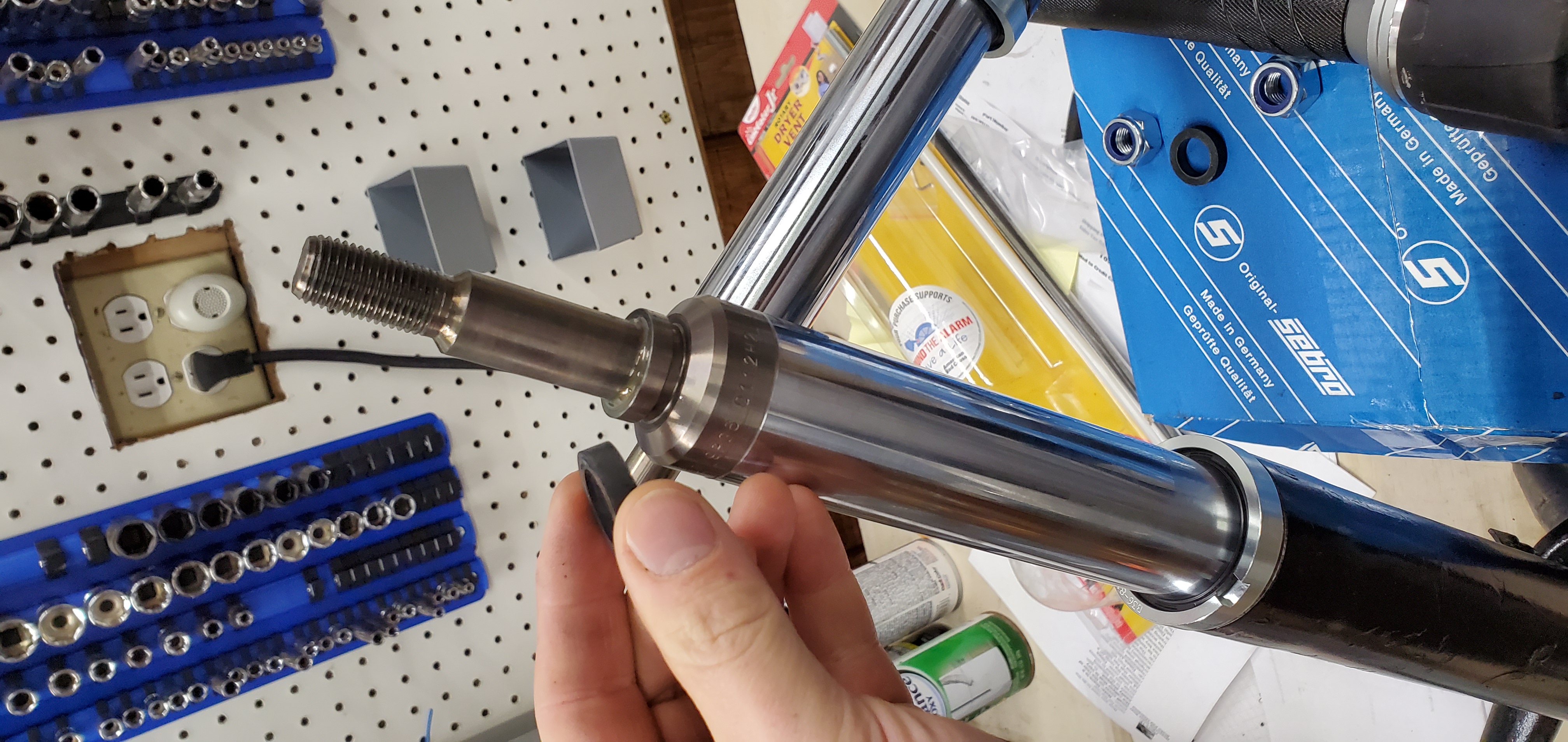

Stupid question for the night. Bilsteins going up front.
Does this little rubber gasket go on between the strut and the top cover as like a bumper? or does it go on after the cover is on between the strut cover and the car?Attached Image

tvdinnerbythepool   Stupid question for the night. Bilsteins going up ...   Dec 2 2019, 09:40 PM
mepstein   Stupid question for the night. Bilsteins going up...   Dec 2 2019, 10:15 PM
