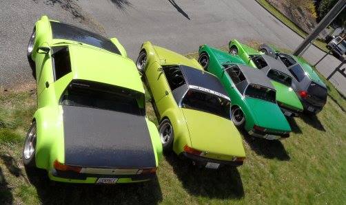

tdskip..your all over the map was a small bore now its a 3.2.....collecting all this intell. ..pull the Fuchin Trigger ..Move Forward with Something.......
type 4 sale turbo, 75/76 exhaust,.blabla bla ...put a fuchin bumper on your toylet....my dad built lots of those conversions..BFD..
