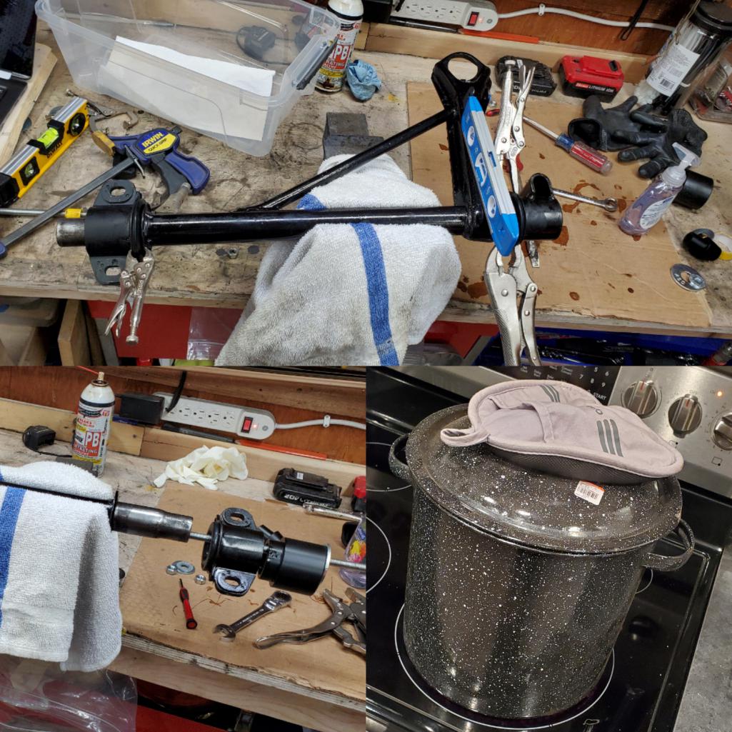

tvdinnerbythepool   Bearings are in! Going to make a threaded to...   Nov 14 2019, 11:11 PM

mepstein   Heat up the fittings that hold the bushings until ...   Nov 23 2019, 01:31 PM
