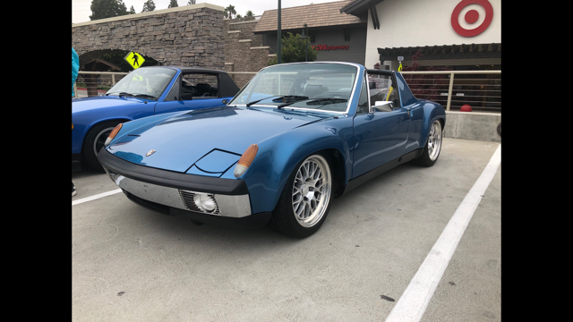

The combination of the color and your rims makes your car look really sexy.
