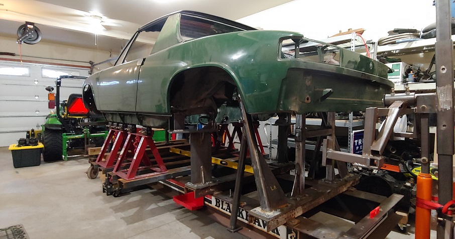

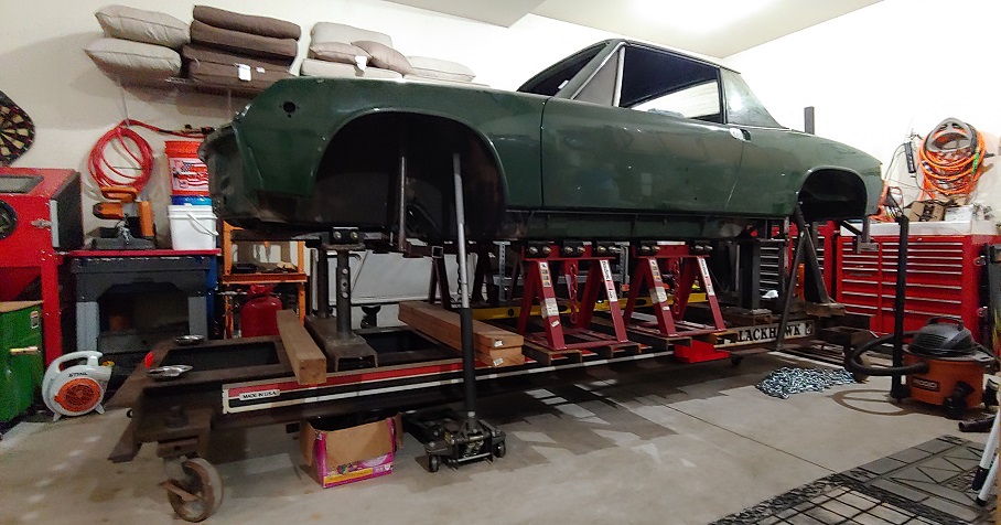

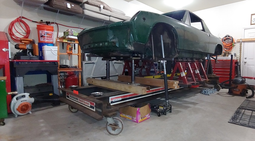

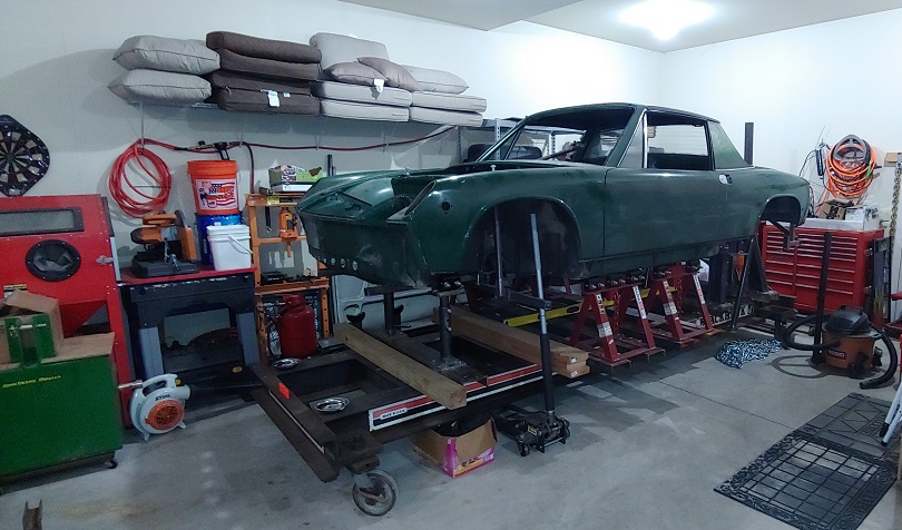

Luke M   Finally got the bench under the 6. This weekend we...   Nov 21 2019, 07:58 AM

Luke M   Got all the fixtures attached between the chassis ...   Dec 5 2019, 12:43 PM

Luke M   Work on mating fixtures to bench..   Jan 23 2021, 08:30 AM
Luke M   Right A-arm mount issue to be addressed. 5-8 mm up...   Jan 23 2021, 08:38 AM

Luke M   Front end fixtures are done. I need to rework the ...   Jan 24 2021, 06:56 AM
Luke M   Got some new tools... I need to wrap up these rear...   Jan 25 2021, 10:51 AM
Luke M   Targa to windshield frame brace is in and got the ...   Jan 26 2021, 10:11 AM

Luke M   The chassis is now locked down on the fixtures and...   Jan 27 2021, 08:10 PM
