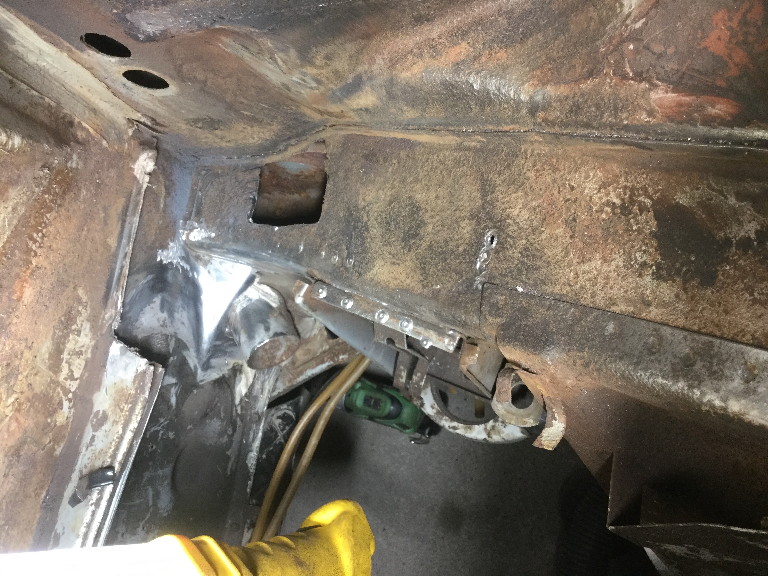

OK, enough “analysis paralysis”! Bought a grinder, some cutting wheels and a spot weld bit set and went to work. I removed the battery tray, rusted engine shelf and cut out the rusted holes on the hell hole ramp. This is double thickness sheet metal and I haven’t found a thread that addresses how to repair this correctly....do I cut two pieces of sheet metal to size and spot weld them together, then butt weld them in? Attached Image

AKFish   OK, enough “analysis paralysis”! Bought a ...   Dec 9 2019, 07:36 PM
AKFish   Today I went digging around the jack post area.......   Dec 9 2019, 07:45 PM
rjames   Today I went digging around the jack post area......   Dec 9 2019, 08:41 PM
AKFish   Today I went digging around the jack post area.....   Dec 9 2019, 10:17 PM
rjames   Yes. I was in a similar situation. The outer layer...   Dec 9 2019, 11:50 PM
jmitro   I removed part of the rear quarter panel to repair...   Dec 9 2019, 09:32 PM
AKFish   @jmitro your project is an impressive feat to be ...   Dec 9 2019, 09:50 PM
dlee6204   Yes. I was in a similar situation. The outer laye...   Dec 10 2019, 03:32 AM
bbrock   On double-walled repairs, I took two approaches. ...   Dec 10 2019, 08:22 AM
