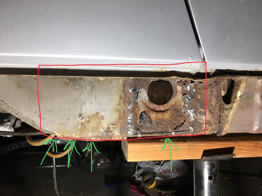

Today I went digging around the jack post area....I clearly need to replace a 10” section of the outer long. I have seen some pretty masterful repairs done to this area, including sleeves etc...
Is it necessary to cut the quarter panel and or door jamb to make this repair?
I’d like to make this car a nice safe driver, so whatever the right path is...I’m open to suggestions.

rjames   Today I went digging around the jack post area......   Dec 9 2019, 08:41 PM
AKFish   Today I went digging around the jack post area.....   Dec 9 2019, 10:17 PM
rjames   Yes. I was in a similar situation. The outer layer...   Dec 9 2019, 11:50 PM
jmitro   I removed part of the rear quarter panel to repair...   Dec 9 2019, 09:32 PM
AKFish   @jmitro your project is an impressive feat to be ...   Dec 9 2019, 09:50 PM
dlee6204   Yes. I was in a similar situation. The outer laye...   Dec 10 2019, 03:32 AM
bbrock   On double-walled repairs, I took two approaches. ...   Dec 10 2019, 08:22 AM
