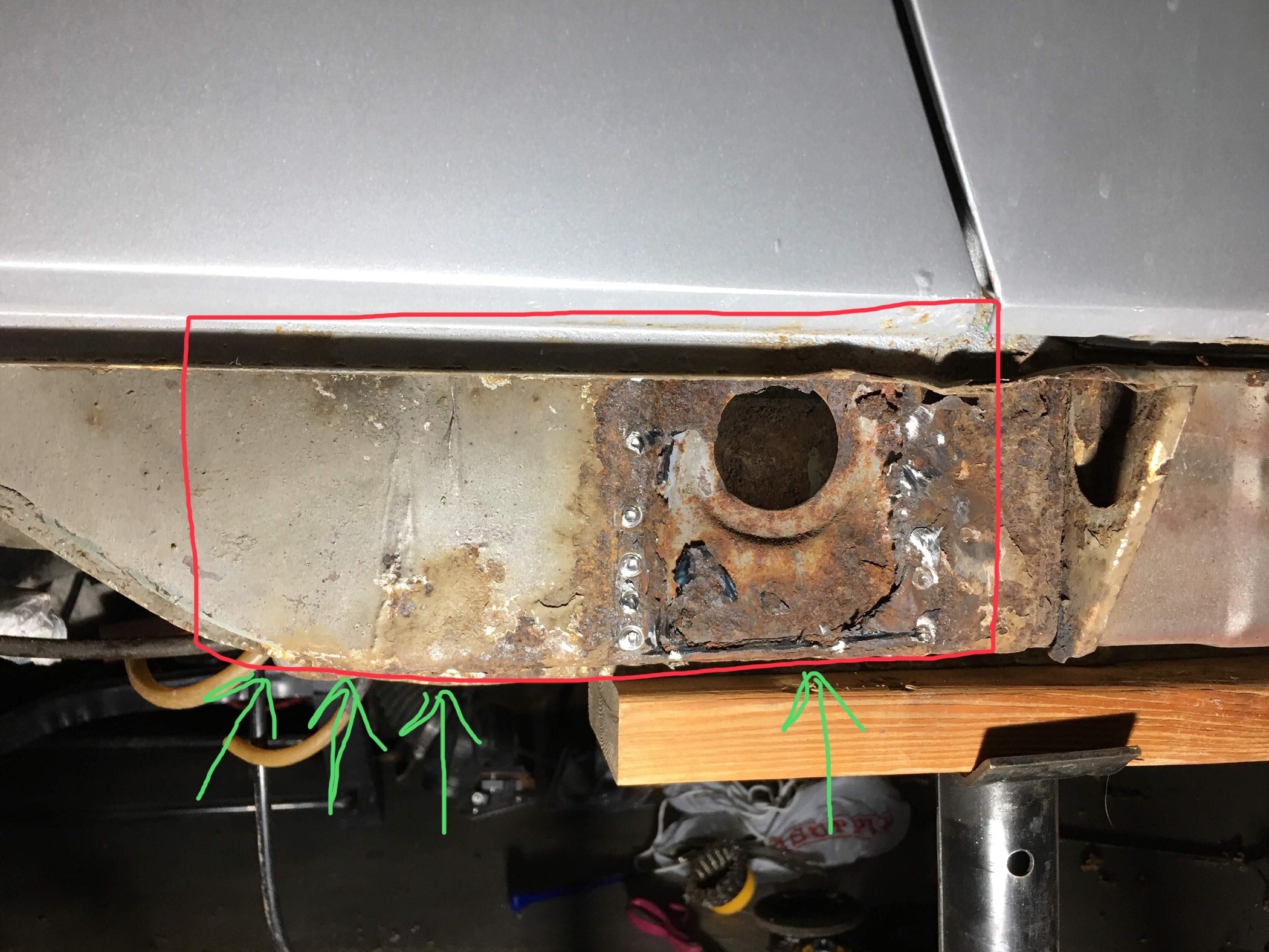

Today I went digging around the jack post area....I clearly need to replace a 10” section of the outer long. I have seen some pretty masterful repairs done to this area, including sleeves etc...
Is it necessary to cut the quarter panel and or door jamb to make this repair?
I’d like to make this car a nice safe driver, so whatever the right path is...I’m open to suggestions.

I'd remove just the outer skin of the area circled in red to see how the layer looks underneath, bracing the car first of course. No sense in cutting out metal if it turns out it's not bad. I'm betting you won't need to fully cut out both layers.

@rjames thanks for the suggestion. Does this technique involve making very shallow cuts and “peeling” away the outer skin? Thanks again!

Yes. I was in a similar situation. The outer layer around the jackpost on my car was bad, but I couldn’t tell if the rust went through to the inner layer. I used a Dremel with a small cutoff wheel to cut the outside layer away. I ended up only having to replace a small piece of the inner layer and a larger part of the outer. Luckily my repairs were pretty minor overall.
Link with a few pictures of my repairs.
