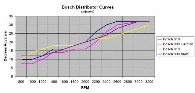

Clay & Perry -
What is it about the advance curve in the 009 that is the problem?
Total advance too much? Starts at too low rpm?
There are those who say the 009 is fine.....
or that it has no vacuum retard?
Just curious......

009 is a great distributor, for a generator engine
The 009 distributor has a lousy advance curve for use in a Type IV. I would not recommend using it. You will be disappointed with it.

Gatornapper   Ok, seeing from this chart what may be the issue. ...   Dec 10 2019, 03:22 PM
yeahmag   It may have been mentioned, but the 009 has too mu...   Dec 10 2019, 05:58 PM

Tdskip   Great chart, helps to visualize the considerations...   Dec 10 2019, 06:39 PM

Gatornapper   Found the advance curve for the Pertronix D182504 ...   Dec 10 2019, 09:04 PM

rbzymek   Here is a graph of the curve base on the Pelican t...   Dec 13 2019, 02:55 PM
