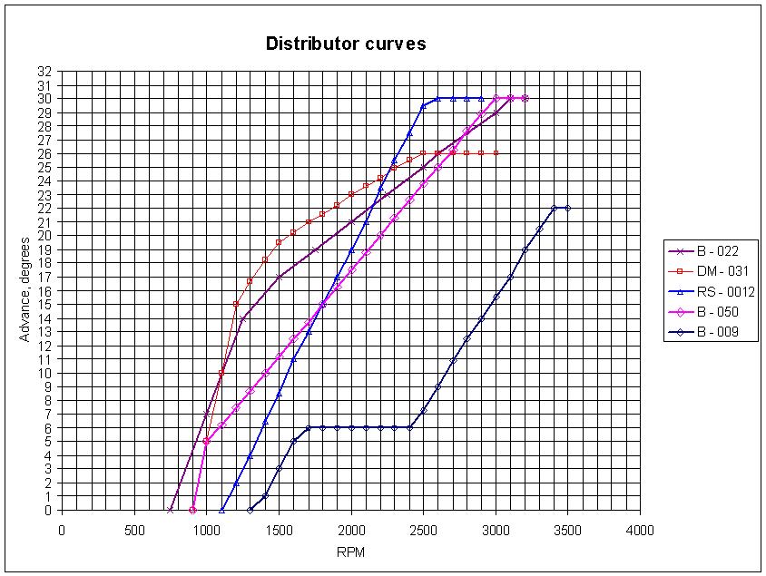

Ok, seeing from this chart what may be the issue.
(IMG:http://www.914world.com/bbs2/uploads_offsite/rennlist.com-21449-1576012948.1.jpg)
On the 050, the advance curve is pretty linear from 1000 rpm up.
On the 090, the curve is not linear, but stays flat from 6 deg. advance at 1700 rpm to 2400 rpm where it starts to suddenly rise at 2400 rpm to 3400.
I can see where this could cause problems.
Interesting the two charts differ somewhat.......
