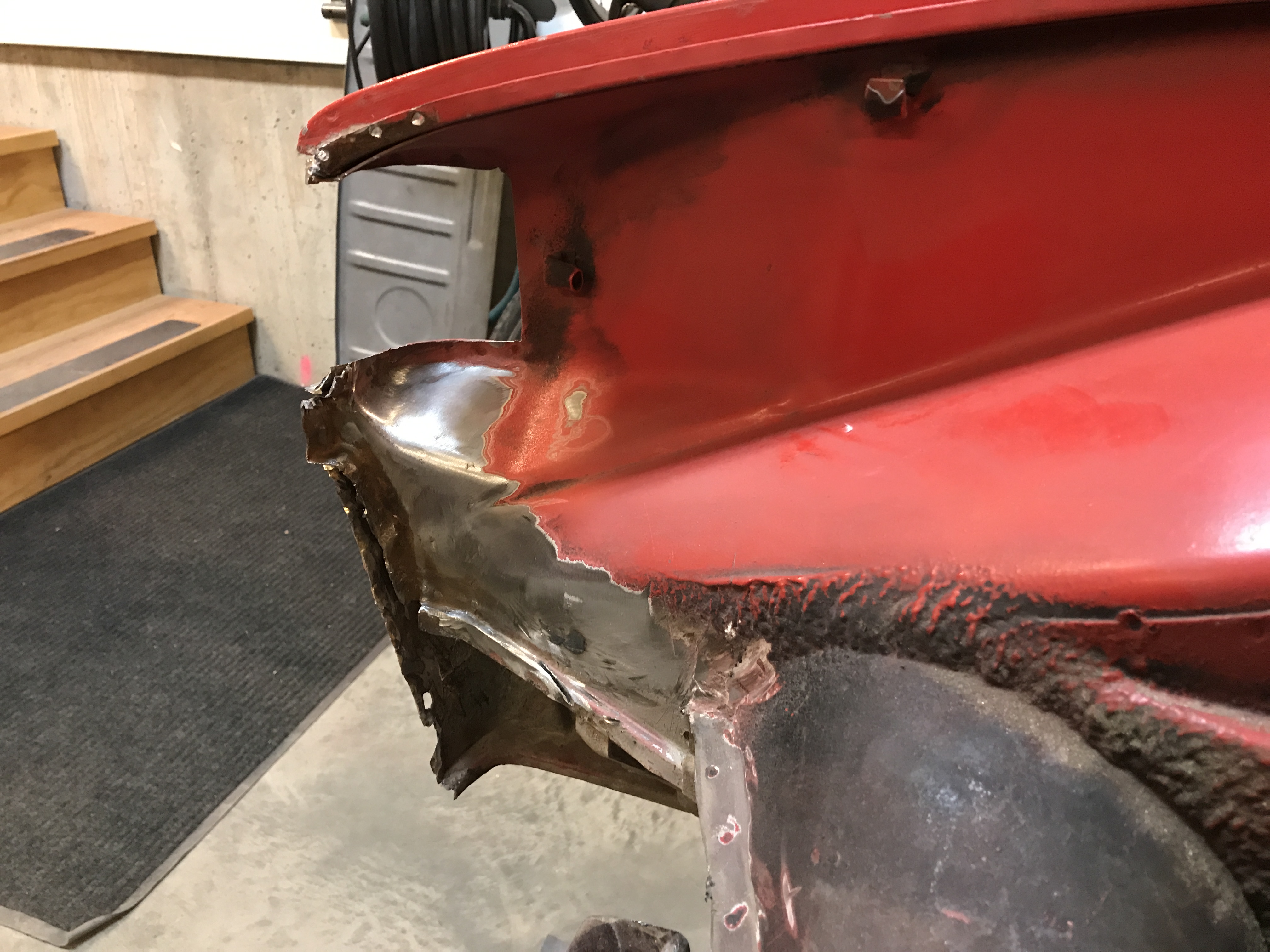

Now starting on the rear. Weeks ago, I cut out the badly rusted rear half of the trunk floor, and also the un-rusty rear panel. That was a replacement during a PO repair, not done well. Took some surgery to undo the triple-layer seams on each side.
Here is the left side, looking not bad, except the seam and lower edges.
