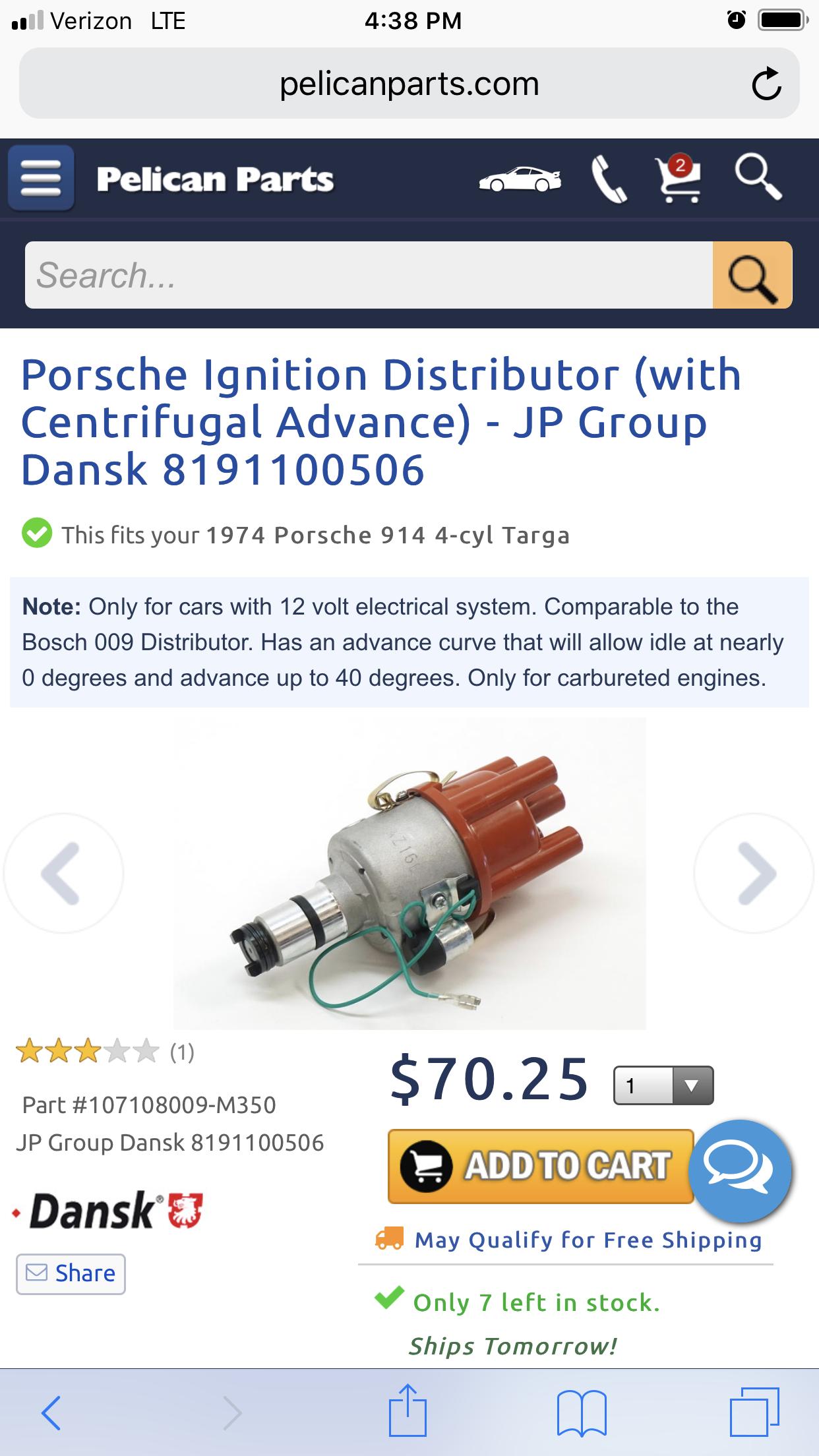

Hoping to NOT muddy the water here but what about something like this?

No mud at all. I looked at these and seriously considered it.....want to see the advance curve first - and see how one would keep the advance to no more than 22 deg.
Checking now to see if I can get the advance curve off of Pelican's site.......if not, I'll call them tomorrow.
On another note, I can get the Pertronix FlameThrower for $133 on Amazon - but one thing that concerns me is about 1/3 of all buyers have something wrong.......not good.......but those for whom it works rave about it.........
Please let us know what they say.
