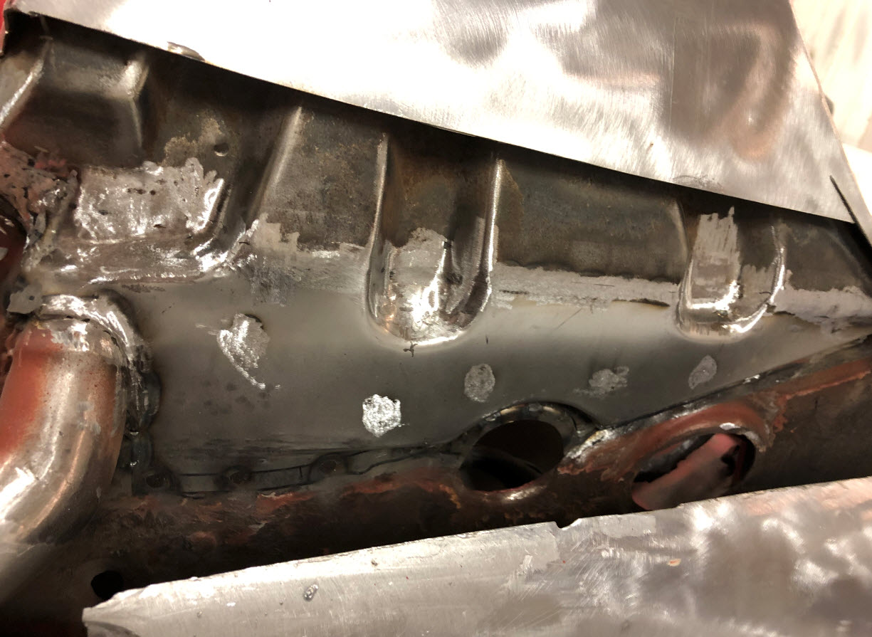

As its close to the weekend, here are some pictures of some more rust (IMG:style_emoticons/default/cheer.gif) .

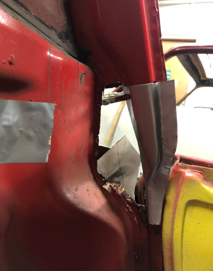

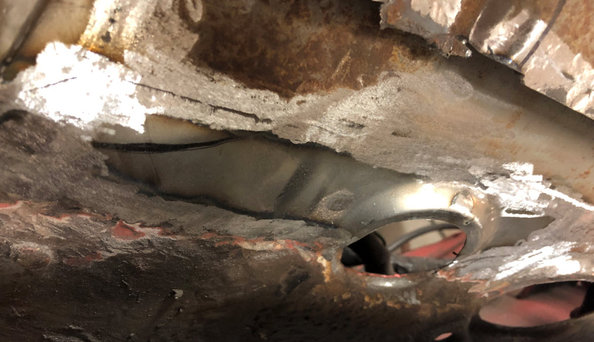

This is from a while back luckily. Internal structure of the roll bar was in really bad shape. Not uncommon I think..
Not much left of the original structure.

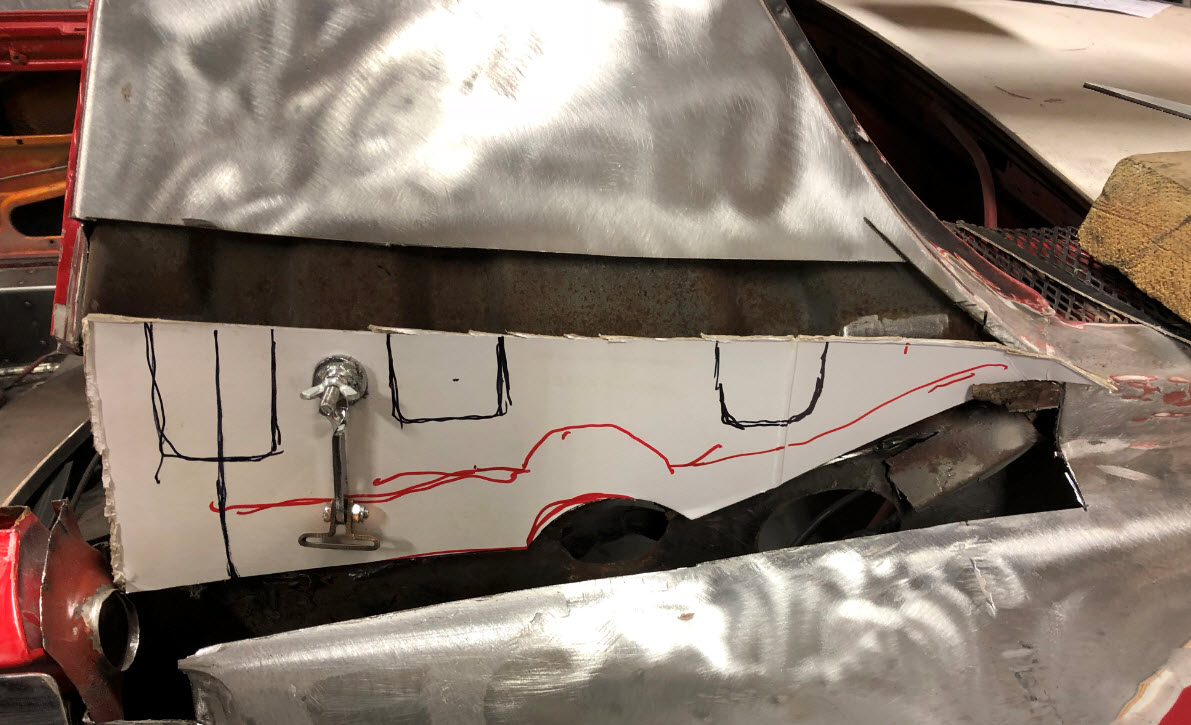

Cardboard repair panel (IMG:style_emoticons/default/idea.gif)

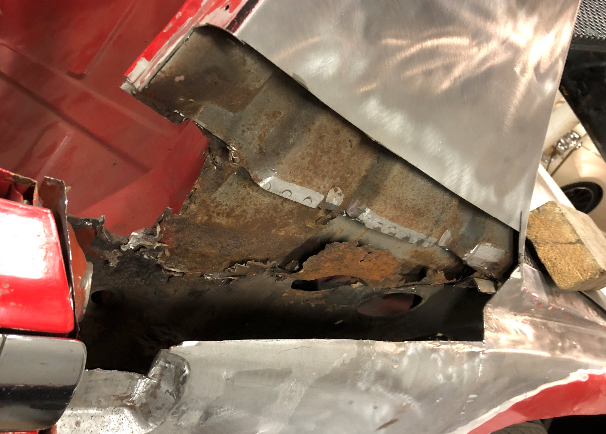

Extencive area was damaged.

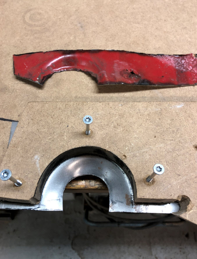

Tool for inner structure.
In place.

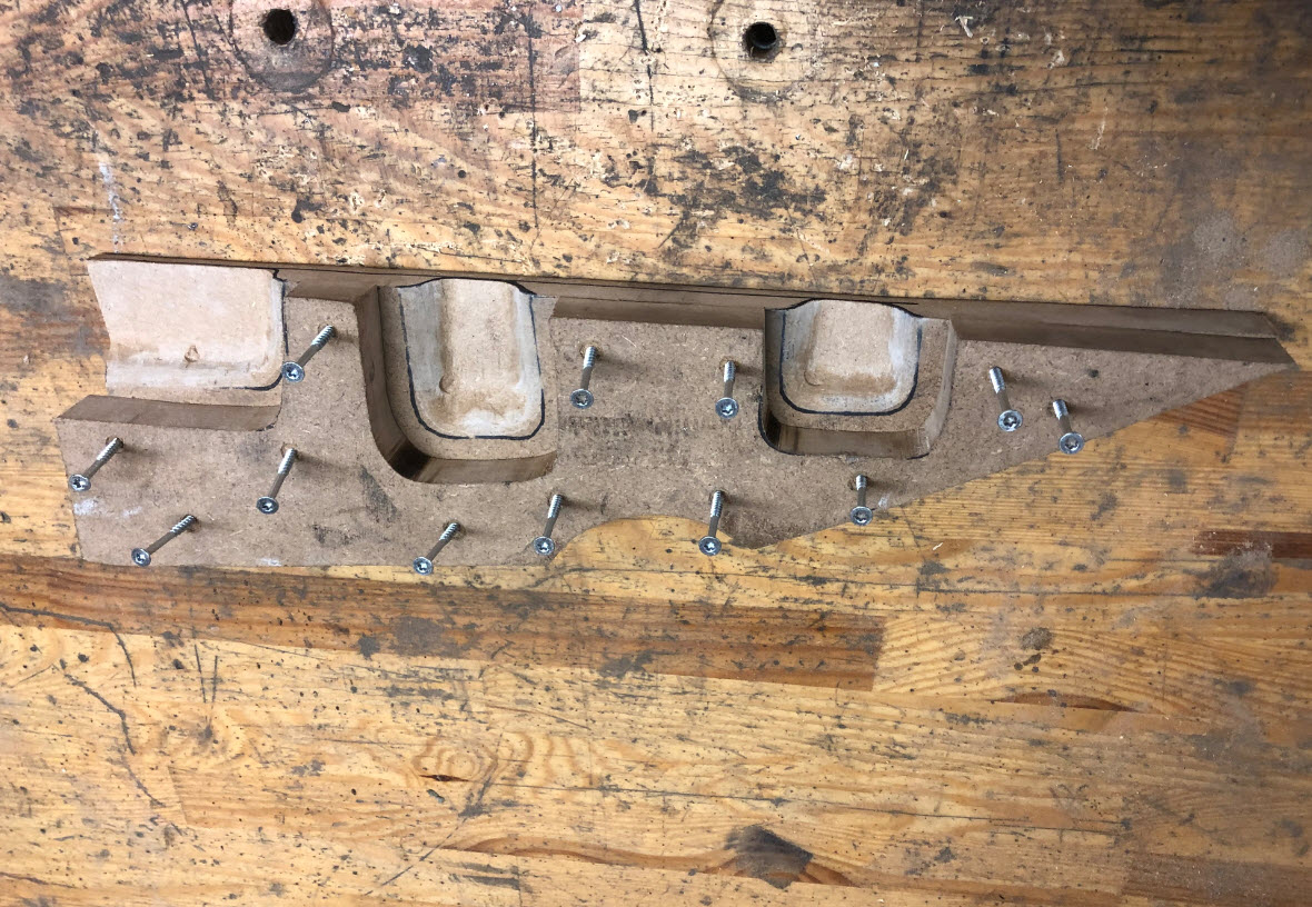

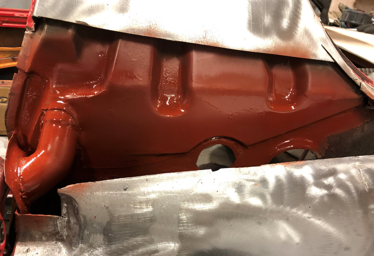

Tooling for outer (inner structure).
In place.
